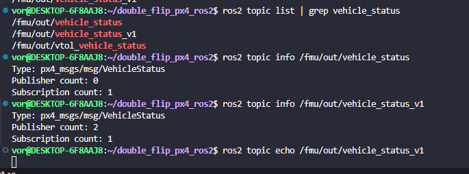

What is the /fmu/out/vehicle_status_v1?

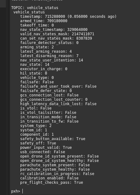

I updated the PX4 Autopilot and lost the vehicle status topic! Why is this happening?
I can see the vehicle status in the QGroundControl MAVLink console, but in ROS 2, the /fmu/out/vehicle_status_v1 topic (which has two publishers) does not publish any messages.
Can someone help me restore the vehicle status topic in ROS 2?

INFO  [uxrce_dds_client] successfully created rt/fmu/out/vehicle_status_v1 data writer, topic id: 284

Ok, I fixed it. I upgraded PX4 Autopilot to version 1.16, and the message format changed. As a result, XRCE creates versioned copies of topics when the received data format differs from the expected one. To resolve this, I synchronized the versions of px4_msgs and PX4 Autopilot and rebuilt the entire workspace.
