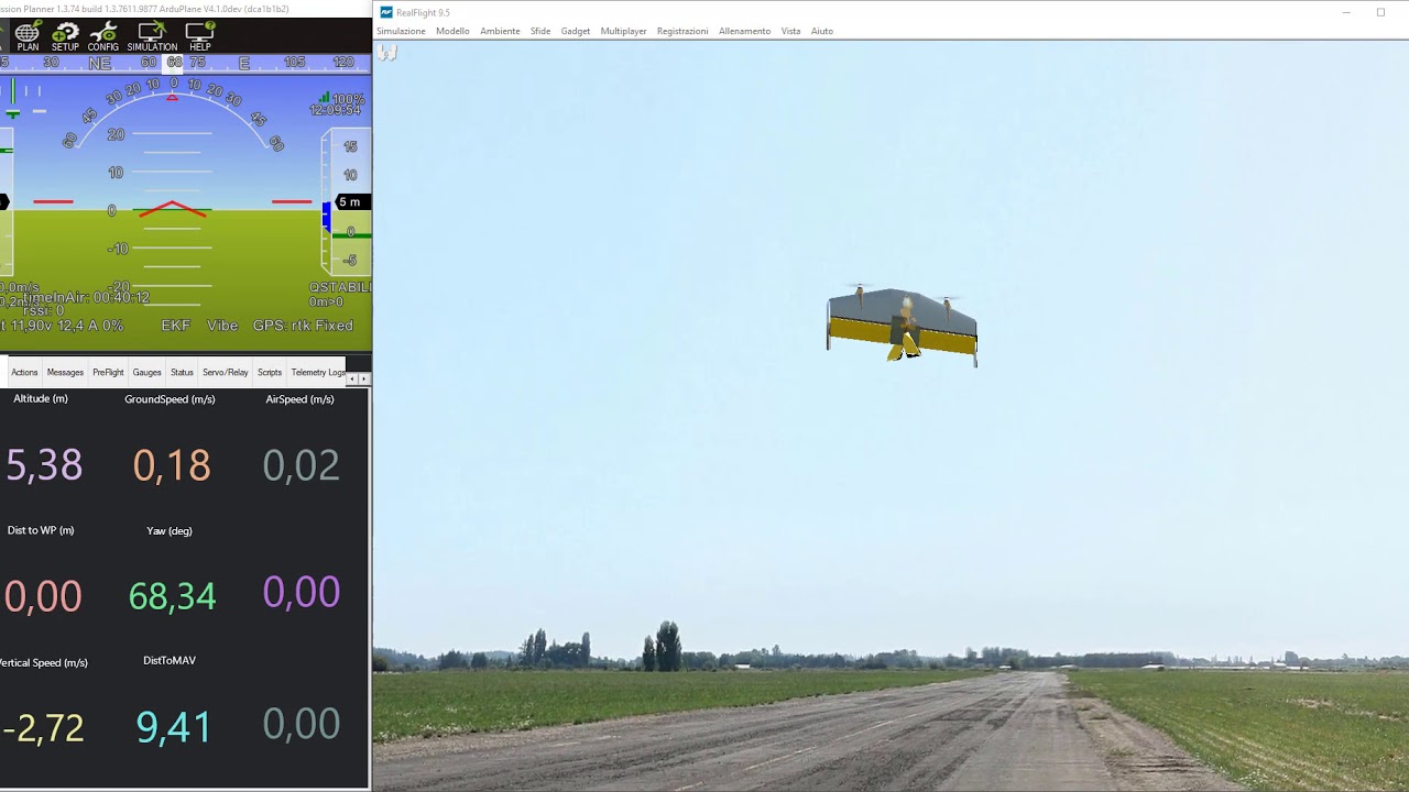

Honestly experimenting with Ardupilot in Realflight is much more realistic, especially when we need to validate some additions to the code.
Realflight ils not opensource and mono platform (windows only) so not really relevant and able to make comparison…
And what does it have to do with what I wrote? :laughing:
Whether it’s open source or not is irrelevant to what I’ve written.
You compare Gazebo to Realflight which is a non sense :
  • opensoure vs proprietary
  • Mono platform vs Multiplatform
  • It’s not diffucult to setup gazebo … assessing it with a video and not a tutorial or other doesn’t make sense… Just saying in a bisounours world : wouhouh you got it working but we don’t care the discussion will not come efficient with such video (it’s clearly relevant on ardupilot discuss forum whre you already post but not here) ! Or may I guess PX4 developers will look at ardupilot PR’s below video you linked, to enhance their FW …
Furthermore posting a video where a weird “mono” platform is present (Mission planner, it could work on Linux (and Mac) but not that much with poor performance and lack of full support. Mono crap thing … ) is definitively not relevant : Mission planner doesn’t support PX4 fw whereas QGroundcontrol support both …
