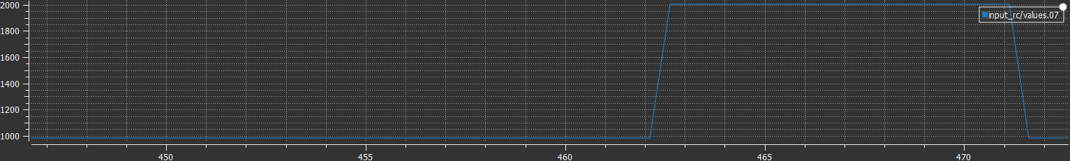

Do you mean ‘Manual Control Input’ in log file graphs or something else for transition switch? because it is not visible under Manual Control Input graph.
Look for parameter RC_MAP_TRANS_SW (its value is 8 in your log)
Then view input_rc topic in the log, you’ll find values.07 (which is the 8th index, count starts at 00)
Seems like your pilot did try to transition back to copter.
I’m sorry this is unhelpful for your actual issue, I can’t help with VTOL.
Your vibrations seem a bit high, although not terrible.
OK, bit confused. are you looking these things with Flight review or some other tool? because i am not able to find such parameters there.
And i can see there was a back transition towards the end, but four hover motors did not start at all. this is also surprising.
Ok, sorry, I’ll explain.
RC_MAP_TRANS_SW is a PX4 configuration parameter. You can edit the vehicle’s configuration via QGC, for example.
Every PX4 carries a copy of the vehicle’s parameters, and you can see that at the bottom of the page at Flight Review, or when you open the log in PlotJuggler (the screenshot I added is from that application. It is recommended to use that if Flight Review isn’t sufficient).
If you’re wondering
To understand the definition of a parameter, Google “px4 params” and you’ll this list, make sure you’re looking at the correct PX4 version.
To understand ulog messages for PX4, take this for example and get yourself familiar with how to find these in the documentaion, Google or the source code.
Again, for VTOL transition I can’t really help. Hopefully You’ve got some tools to get started with log analyzing, although it’s quite overwhelming for someone unfamiliar with it.
If you can, you’re welcome to read the source code for VTOL transition and understand what went wrong and why the quadcopter motors didn’t start (or look it up in documentation).

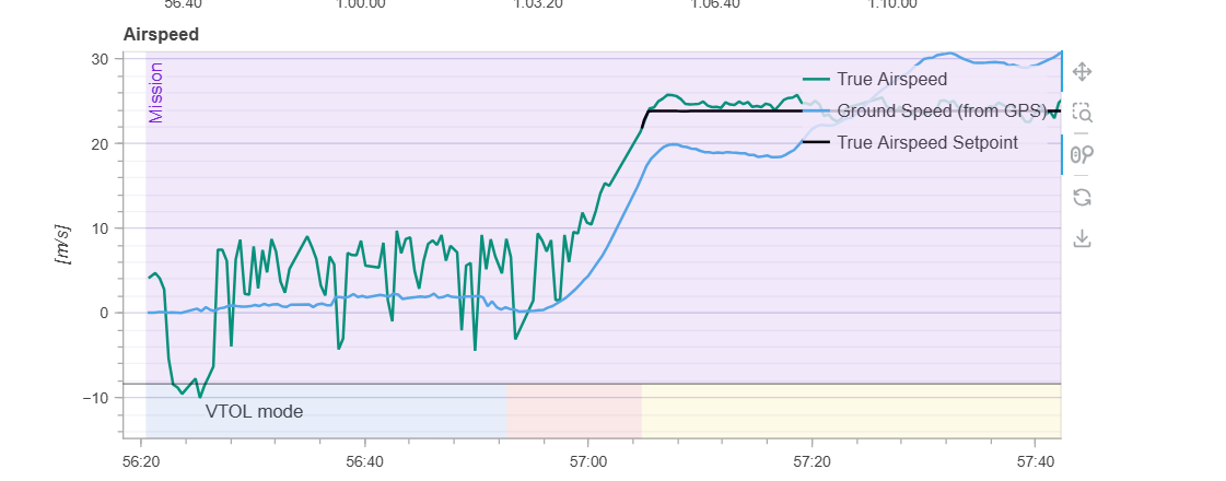

from the first glance the airspeed readings are all over the place. Maybe calibration is bad or the on of the ports of the airspeed was loose or leaking. Cause even the mounting error should have a reading like that.
Here is one of ours from the start of the flight and transition process. Using ms4525do sensor:
Check Quad-chute Failsafe in Safety (Failsafe) Configuration | PX4 Guide (main)
