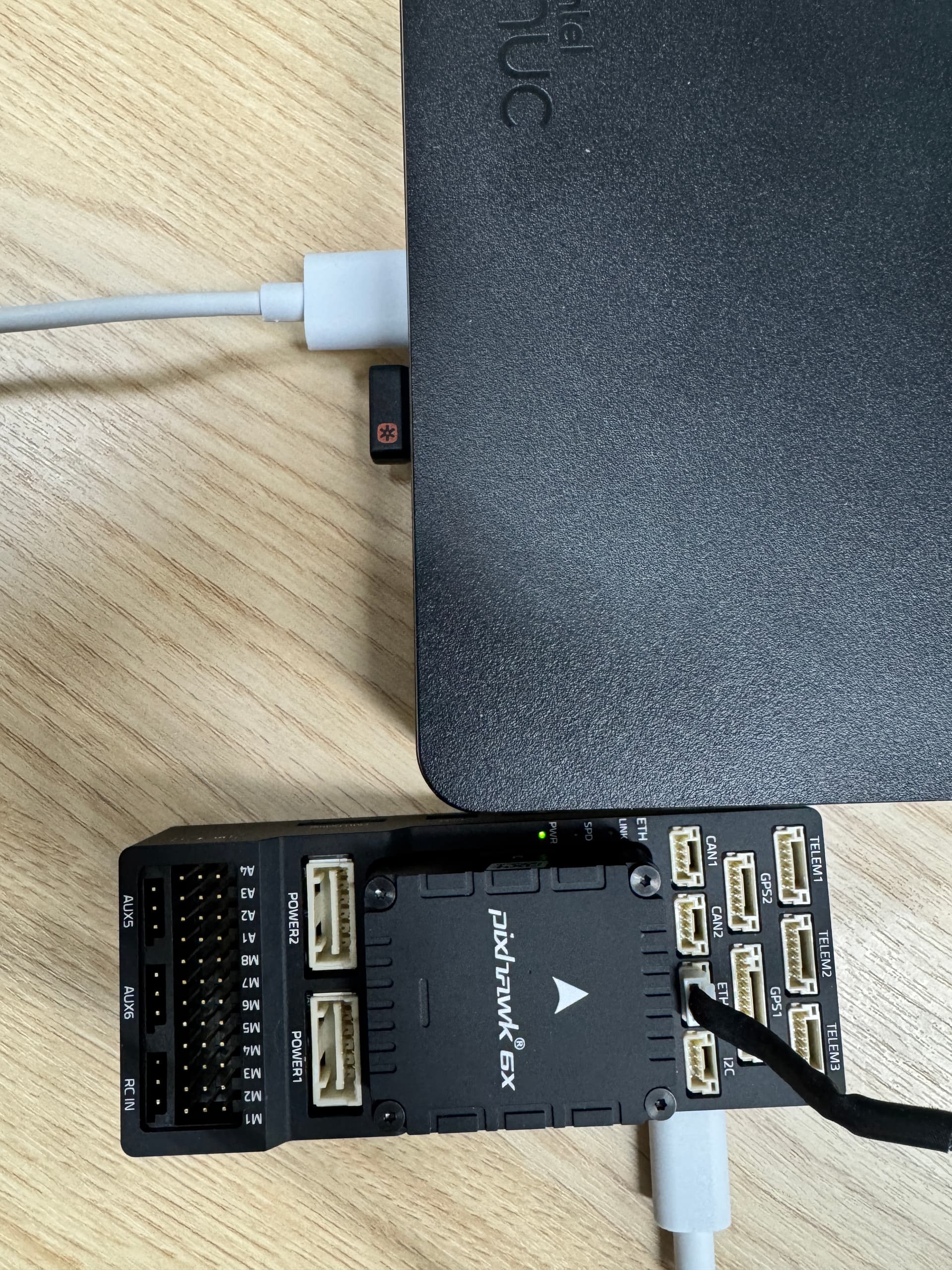

Hardware Specification
Name SPEC
Companion Computer Intel NUC
OS Ubuntu 22.04.5 LTS
ROS 2 version Humble
Drone Holybro S500 V2
Flight Controller Pixhawk 6X
uXRCE-DDS connection ETH

cowboy@GCSL-NUC1:~$ ip route
default via 192.168.50.1 dev wlo1 proto dhcp metric 600
169.254.0.0/16 dev wlo1 scope link metric 1000
192.168.50.0/24 dev wlo1 proto kernel scope link src 192.168.50.112 metric 600
cowboy@GCSL-NUC1:~$ ip addr
1: lo: <LOOPBACK,UP,LOWER_UP> mtu 65536 qdisc noqueue state UNKNOWN group default qlen 1000
    link/loopback 00:00:00:00:00:00 brd 00:00:00:00:00:00
    inet 127.0.0.1/8 scope host lo
       valid_lft forever preferred_lft forever
    inet6 ::1/128 scope host
2: enp86s0: <NO-CARRIER,BROADCAST,MULTICAST,UP> mtu 1500 qdisc mq state DOWN group default qlen 1000
    link/ether 48:21:0b:60:55:95 brd ff:ff:ff:ff:ff:ff
3: wlo1: <BROADCAST,MULTICAST,UP,LOWER_UP> mtu 1500 qdisc noqueue state UP group default qlen 1000
    link/ether 30:f6:ef:44:07:f5 brd ff:ff:ff:ff:ff:ff
    altname wlp0s20f3
    inet 192.168.50.112/24 brd 192.168.50.255 scope global dynamic noprefixroute wlo1
       valid_lft 77626sec preferred_lft 77626sec
    inet6 fe80::3b05:fa8:e805:11b1/64 scope link noprefixroute

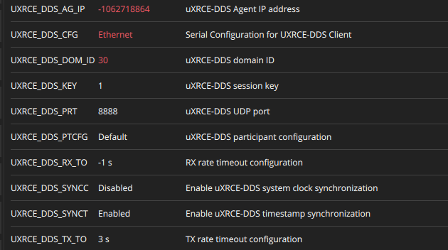

nsh> uxrce_dds_client start -t udp -b 921600 -h 192.168.50.1 -p 8888
INFO  [uxrce_dds_client] init UDP agent IP:192.168.50.1, port:8888
nsh> uxrce_dds_client status
INFO  [uxrce_dds_client] Running, disconnected
INFO  [uxrce_dds_client] Using transport:     udp
INFO  [uxrce_dds_client] Agent IP:            192.168.50.112
INFO  [uxrce_dds_client] Agent port:          8888
INFO  [uxrce_dds_client] Custom participant:  no
INFO  [uxrce_dds_client] Localhost only:      no
INFO  [uxrce_dds_client] timesync converged: false

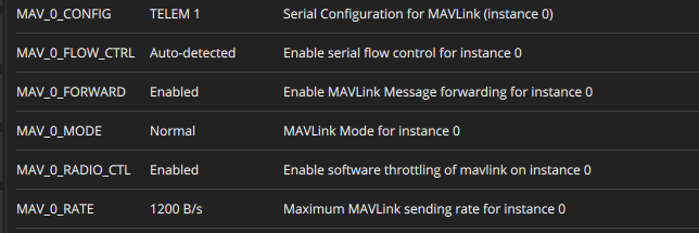

nsh> mavlink status
instance #0:
    mavlink chan: #0
    type:        GENERIC LINK OR RADIO
    flow control: ON
    rates:
      tx: 768.0 B/s
      txerr: 0.0 B/s
      tx rate mult: 0.328
      tx rate max: 1200 B/s
      rx: 0.0 B/s
      rx loss: 0.0%
    FTP enabled: YES, TX enabled: YES
    mode: Normal
    Forwarding: On
    MAVLink version: 1
    transport protocol: serial (/dev/ttyS6 @57600)

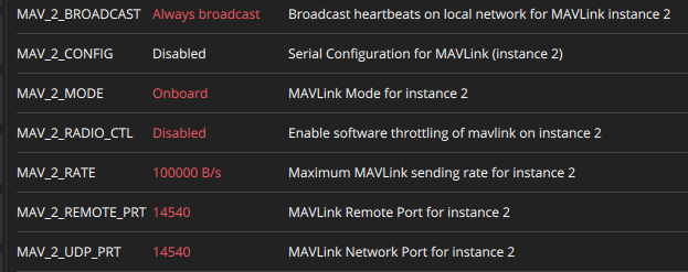

instance #1:
    GCS heartbeat valid
    mavlink chan: #1
    type:        USB CDC
    flow control: OFF
    rates:
      tx: 21243.9 B/s
      txerr: 0.0 B/s
      tx rate mult: 1.000
      tx rate max: 100000 B/s
      rx: 46.9 B/s
      rx loss: 0.0%
    Received Messages:
      sysid:255, compid:190, Total: 7080 (lost: 240)
    mode: Onboard
    Forwarding: On
    MAVLink version: 2
    transport protocol: serial (/dev/ttyACM0 @2000000)
