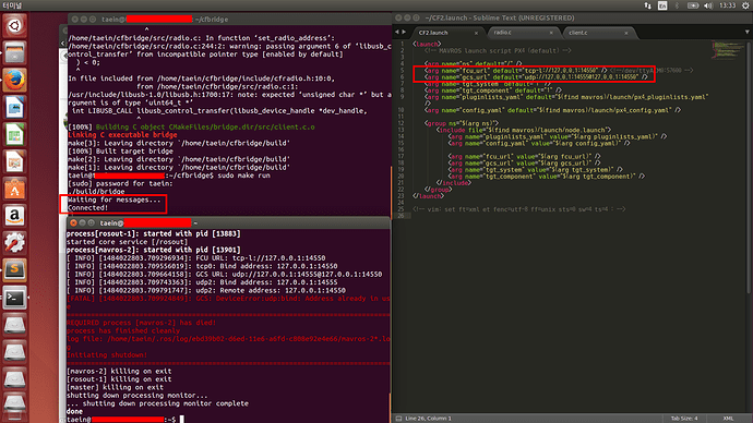

I would like to use “mavros” to output the sensor value or data of Crazyflie to the terminal. However, “CrazyRadio PA” does not support serial connections (CrazyRadio PA uses
a proprietary protocol called “CRTP”). So I have to use the ‘mavros.launch’ form, and I’m having trouble with fcu_url, gcs_url configuration . Is there a solution?
The PX4 implementation allows communicating via Mavlink over CRTP. See the end of http://dev.px4.io/hardware-crazyflie2.html#wireless for information on how to do this. Then mavros can be connected as if there was an fcu on local port 14550
@dennisss
Thank you for your help!. So I’ve tried many, but I still have difficulties with url configuration. I’ll show you my specific situation through image upload. The image is the xml source of mavros.launch.
p.s i use cfbridge
have a nice day denniss!
I haven’t used mavros in a while, but I’m pretty sure you don’t need the gcs_url argument as that is usually for when you are using qgroundcontrol as well (so get rid of that line). The fcu_url should be udp based, so something like <arg name="fcu_url" default="udp://:14550@:14555" /> should work. That would specify to listen on local 14550 for messages and send outbound messages to 14555.
Oh, I got it! I understand your reply.
Now, I will apply that to my project.
Thanks @dennisss!
