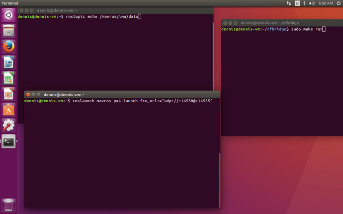

This is my setup for making this work:
  1. I have three terminals.
    First I start one on the right to connect cfbridge
    Next I use bottom-left one to connect mavros
    Finally I use top-left one to print data from mavros. I got /mavros/imu/data by doing rostopic list and then picking an interesting one from the list
  2. This is the result of running those commands:
thanks to reply, @dennisss!! I understood and analyzed the screen image that you attached.
Um… I have the same screen as you. But I would like to ask you to “echo” the "/mavros/imu/data_raw" from the “rostopic list” instead of "/mavros/imu/data". Do you receive data? I do not get any data. But when I connected Crazyflie to the serial port via USB, "/imu/data_raw" data came in. If you use “cfbridge”, the "/imu/data_raw" data will not come in. Please check this part.
data_raw is not configured to be transmitted over the radio as we would like to by default limit the amount of non-essential data going over the connection.
Mavlink in PX4 has different modes which define how much data is sent. This line specified that the crazyflie should be in osd mode: https://github.com/PX4/Firmware/blob/master/ROMFS/px4fmu_common/init.d/rcS#L630.
If you examine the mavlink program (https://github.com/PX4/Firmware/blob/master/src/modules/mavlink/mavlink_main.cpp#L2047), osd mode does not send HIGHRES_IMU which is what data_raw listens to. Meanwhile, usb is usually configured in normal mode (https://github.com/PX4/Firmware/blob/master/src/modules/mavlink/mavlink_main.cpp#L1988) which sends just about everything including HIGHRES_IMU.
Please consider either changing the mode in the rcS file, or adding custom streams to mavlink if you really need this data.
