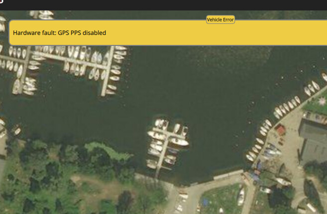

Use PPS from GNSS to sync time for FLARM
I want to use PPS signal form GNSS module, inject using AUX5 as GPIO PPS input, but after configuration Pixhawk still doesn’t show PPS. Any suggestions? Pixhawk 6x v2a with PX4 stable v1.15.4 and Ublox M10
That will require some work. For us to help it might help to give some context on why you want/need this.
FLARM requires precise time synchronization with GNSS, in a standard configuration the jitter is 5-10 ms, and during long missions FLAM may stop working due to time synchronization jitter exceeding 10 ms. So in this case we want to allow to inject PPS signal for better time sync.
Ok, understood. What’s FLARM? :thinking:
FLARM is a collision avoidance system, used by gliders, UAV, helicopters and more. FLARM use 868 MHz frequency to share data (similar to ADS-B) and has implemented avoidance algorithm to prevent collisions. In PX4 we have similar functionality based on ADS-B.
Ok, I understand.
Have you had a look at this? Maybe that helps.
I compiled this and uploaded it to my Pixhawk 6x v2A, connected the PPS signal to FMU AUX 1 (pin S as INPUT), configured it as PPS INPUT, but still nothing…

You will have to look at the code and parameters of how this works or what it does. I don’t know myself.
Okay, thanks. I will update after research
Seems like pps_capture working in background but doesn’t appear in timestamp or in pps_capture status. When I disconnect PPS cable, QGroundControl throw error message. This message is directly from mavlink protocol. Any idea?
Comes from here:
I added more info into driver and there is no connection between pps_capture and gps timestamp_sample. I don’t see any real time correction in PX4, so maybe it is good idea to add tihs feature?
pps_capture debug
INFO  [pps_capture] ==== PPSCapture Debug State ====
INFO  [pps_capture] Channel: 3
INFO  [pps_capture] GPIO Pin: 65914
INFO  [pps_capture] Last GPS UTC: 1748950191899817
INFO  [pps_capture] Last GPS timestamp: 1606987421
INFO  [pps_capture] Latest HRT timestamp: 1607037821
INFO  [pps_capture] PPS Rate Exceeded Counter: 0
INFO  [pps_capture] Time GPS + PPS UTC: 1748950191950217
INFO  [pps_capture] PPS Rate Failure: false
Of course, I can share my code for better understanding
