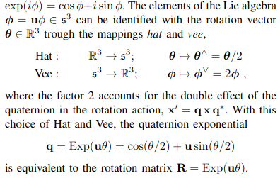

  // using sin(alpha/2) scaled rotation axis as attitude error (see quaternion definition by axis angle)
  // also taking care of the antipodal unit quaternion ambiguity
  const Vector3f eq = 2.f * qe.canonical().imag();
  // calculate angular rates setpoint
  matrix::Vector3f rate_setpoint = eq.emult(_proportional_gain);
This bit creates a vector, eq from the qe’s imaginary parts and scales it by 2. This is a small angle approximation of the Logmap of q. I wonder if the full calculation was too costly?
The intent here is to be to convert eq into its euler angle equivalents via this equation:
It then constructs the rate_setpoints by multiplying the euler angle delta by the rate gains.

Just for clarity, it’s computing the “global rotation difference” (both z vectors are expressed in the global frame), this is why it needs to be right-multiplied by the attitude.
Here is the important part: the “tilt” part of this “quaternion error” depends on MC_YAW_WEIGHT; you don’t get the same desired roll and pitch rates with different yaw weights.
There are many trajectories you can follow to move from an attitude to another one: the more direct one is obtained when yaw weight is 1. The other extreme case would be to set the yaw weight to 0 and add a separate controller for the yaw axis. Here, we have a blend of the two cases.
We need a body rate setpoint for the rate controller, this is why we take the “local error”. This tangent 3D vector is really just the delta rotations around the x, y and z body axes.
It’s a bit more costly to do, yes, and it doesn’t affect stability.
Not delta euler angles but delta angles around each axis of the current attitude.
I think here I was referring to q_mix being calculated as a local difference. I shouldn’t have said “instead” it is just correct to do it this way.
Oh right. Duh. It is motivated to use the body rate vector. Makes sense.
Okay, yes. Local attitude rotations, not euler angles.
Ah. I understand now. It is because the affected rate setpoints are local setpoints. I was thinking of them as tho they were global. Okay this makes sense now. I will mark it as resolved.
