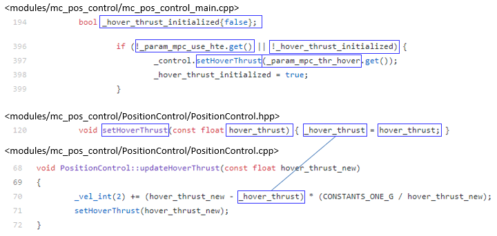

Looking at the scripts below, it seems that “_hover_thrust” is equal to “MPC_THR_HOVER” (_param_mpc_thr_hover) at first, not “hover_thrust_new”. Please correct me if I’m wrong.
If so, “hover_thrust_new” comes from the “mc_hover_thrust_estimator” module?
I can’t follow from “hte.hover_thrust” in a script below to “mc_hover_thrust_estimator” module. Any help would be appreciated.
Hi @crest_wave ,
Currently, he hover thrust estimator (HTE) is only active when at least the z controller is active (altitude, position and auto modes, not acro and stabilized). This is why the hover thrust is always set at boot using MPC_THR_HOVER and then updated with the estimate if available.
HTE publishes its value here:
The position controller subscribes to it and gets the value here:

Could you help me to understand how the updateHoverThrust function “cancel out” the the effect of the thrust estimator addition on the altitude loop?
The updateHoverThrust function adds the _vel_int(2) as below, right? But, how is it “cancel out” the effect?
_hover_thrust is set through setHoverThrust and is also called in updateHoverThrust.
So hover_thrust_new - _hover_thrust is the difference between the last iteration and now.
In other words, in the first iteration, it’s correct that _hover_thrust = MPC_THR_HOVER but that’s not the case during the whole flight, as soon as updateHoverThrust is called, this value is updated as well.
Thank you very much for your explanation.
Now, I understand how the _hover_thrust and hover_thrust_new are updated.
But, still I don’t have a clear understanding how the expression below is came up and how the updateHoverThrust function “cancels out” the the effect of the thrust estimator addition on the altitude loop. I appreciate your help.
