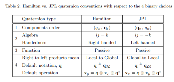

Hi zhihao,
Operating under the assumption that the quaternion q_nb transforms a vector expressed in the “b” reference frame coordinates to a vector expressed in “n” reference frame coordinates, the following equation will translate the SAME vector from “b” coordinates to “n” coordinates:
[0;v_n] = q_nb * [0;v_b] * q_nb^(-1)
Now let’s look at what happens when we move the quaternions to the Left-Hand side of the equation:
[0;v_n] = q_nb * [0;v_b] * q_nb^(-1) →
q_nb^(-1) * [0;v_n] * (q_nb^(-1))^(-1) = [0;v_b] →
q_nb^(-1) * [0;v_n] * q_nb = [0;v_b]
This is the same equation, but now we’re using the quaternion q_nb to transform the vector [0;v_n] from “n” reference frame to “b” reference frame. This illustrates how both equations you described are applicable, but what’s more important is understanding what basis transformation the quaternion is applying. Hope this helps!

Hi zhihao,
I appreciate your response! It appears there’s a disrepancy in our understandings of the reference frame order “nb” in q_nb.
I’ve done some investigation into mc_att_control AttitudeControl.cpp and my understanding was a little different. To parallel your wording with my understanding:
The quaternion “q_nb represents the transformation of coordinate frame b to coordinate frame n, which means that if coordinate frame b, rotates about an axis u, (i don’t think the frame of rotation axis u is too relevant because the coordinates should be consistent in frame n and b), -2theta angle, will obtain the coordinate frame n”. See my understanding was that the 2theta angle becomes a negative 2theta angle, and this is why I have been comfortable using the equation:
[0; v_n] = q_nb * [0;v_b] * q_nb^(-1)
The reason I’ve used the -2theta angle is because q_nb appeared to me to act like a Direction-Cosine Matrix and not a Rotation matrix. If I translate q_nb to its corresponding direction-cosine matrix (let’s call it C_nb), then:
[0;v_n] = q_nb * [0;v_b] * q_nb^(-1) is equivalent to
{v_n} = C_nb *{v_b}
where v_n and v_b are the same vector expressed in reference frame coordinates of n and b respectively. If it were the other way around as you have independently determined, I think it would instead have looked like:
[0;v_b] = q_nb * [0;v_n] * q_nb^(-1) is equivalent to
{v_b} = C_nb * {v_n}
I have previously tried testing the DCM(quaternion q) constructor and the quaternion multiplication functions in parallel and was able to re-create the expected result, but I’d have to dig up the matlab scripts I used to remember what I did.
Regardless, there definitely seems to be some inconsistency between both our understandings of how the PX4 is representing its quaternions, and I am in a similar position where understanding this discrepancy would be immensely helpful to me in the future. Is there anyone else who can clarify the correct interpretation?

Hi zhihao,
Thank you for the constructor function! I have looked into it a little more, and I am still thinking that the quaternion is constructed like a DCM rather than a rotation (as per the definition I’d written earlier).
I would like to say that I believe your interpretation from the beginning was correct. The convention you were using would state the following for a coordinate transformation from body axes to NED axes:
[0;v_n] = q_bn^(-1) * [0;v_b] * q_bn ------ (equation 1)
But it just turns out that the convention PX4 is using is q_nb as its quaternion (q_nb^(-1) = q_bn).
So if I take equation 1 and use substitute in q_nb^(-1) for q_bn, I get:
[0;v_n] = (q_nb^(-1))^(-1) * [0;v_b] * q_nb^(-1) ----->
[0;v_n] = q_nb * [0;v_b] * q_nb^(-1) ------ (equation 2)
Which is why they are using equation 2 instead of equation 1. Does this seem to help answer your original question?

Hi zhihao,
Just to clarify, my understanding is that q_nb is the equivalent of a ROTATION matrix that will rotate a vector {v_n} such that it is actively rotated to become new vector in n-frame {vnew_n}. {vnew_n} is {v_n} rotated by +theta about the rotation axis between from n to b. This uses your vector rotation equation:
{0;vnew_n} = q_nb * {0;v_n} * q_nb^(-1)
When q_nb is used as a Direction-Cosine Matrix, it takes the vector {v_b} and represents that same vector in the n-frame {v_n} when using the same equation.
{0;v_n} = q_nb * {0;v_b} * q_nb^(-1)
The axis-angle to quaternion conversion uses +2theta by my equation:
The axis-angle to quaternion conversion uses -2theta by your equation:
{0;v_n} = q_nb^(-1) * {0;v_b} * q_nb
but I am sorry I see now that saying -2theta may have just increased confusion further. I want to ask you one further question that may aid us. What is the formula you are using when multiplying two quaternions? Furthermore, do you happen to have an English link to where you got the formulas you are using?

@zhihao you are right.
the quternion q_nb means rotating vector v_b in body frame to vector v_n in ned frame. you can see the description of rotateVector() function from here.
We’re using the Hamilton convention as described in this paper.
(source: https://arxiv.org/pdf/1711.02508 page 34)
