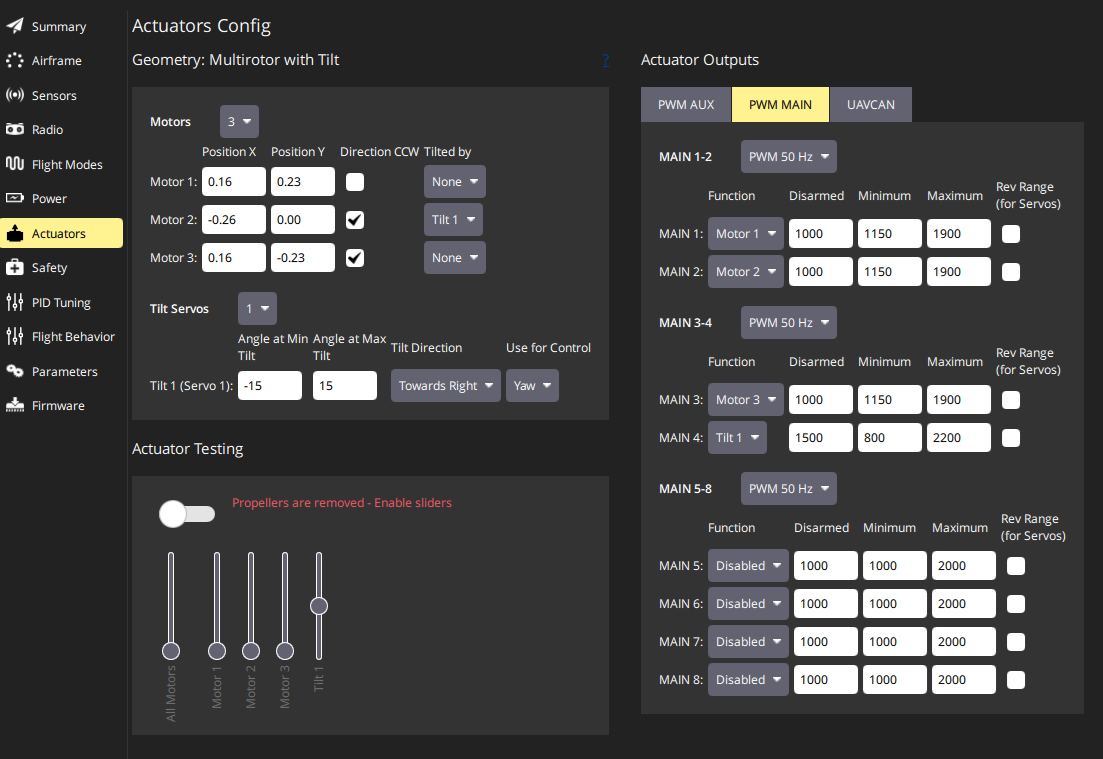

Dear all,
I am new in px4 and pixhawk 6x, but have some experience in the rc world… I am setting up a tricopter with tilting the rear motor (MAIN2) with a servo plugged in in MAIN4. So far the tilting servo is not responding and I think I have done properly the setup of the actuators. Attached screenshot of the configuration in QGroundControl:
Would you be so kind to help me with this issue? thanks in advance
Does it also not work once you arm?
Hi, it is solved already… pixhawk 6x does not provide power supply to the servos… only PWM signal… thanks for your time…
