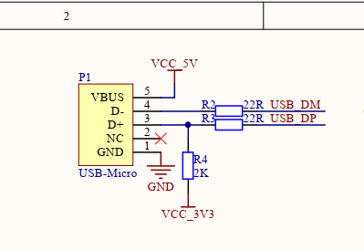

My board is based on the FMUv4 design, but the USB VBUS hardware is different from the reference board.
On the FMUv4 reference design, the VBUS sense line is connected to PA9.
On my custom board, however, VBUS is tied directly to 5V5, so it is not routed to PA9 in the same way as the original FMUv4 board.

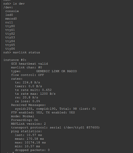

However, after the PX4 application firmware starts, USB MAVLink does not come up, so QGroundControl cannot connect over USB. As a workaround, I connected QGC through TELEM1, and after reducing the MAVLink data rate there, parameter download and setup became stable.

  • but USB MAVLink does not start in the PX4 app
One thing I noticed is that in PX4 v1.14.0, I cannot find any cdcacm_autostart or mavlink start -d /dev/ttyACM0 section in ROMFS/px4fmu_common/init.d/rcS. It seems that in this version rcS only sources rc.serial, so I suspect the problem may be in the app-level board config, NuttX USB config, or generated serial startup rather than in rcS itself.

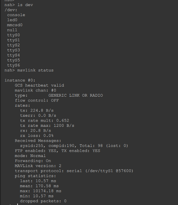

  • ls /dev
  • mavlink status
  • schematic of the USB section
I also attached the USB schematic snippet showing that VBUS is tied to 5V5 on my custom board.
