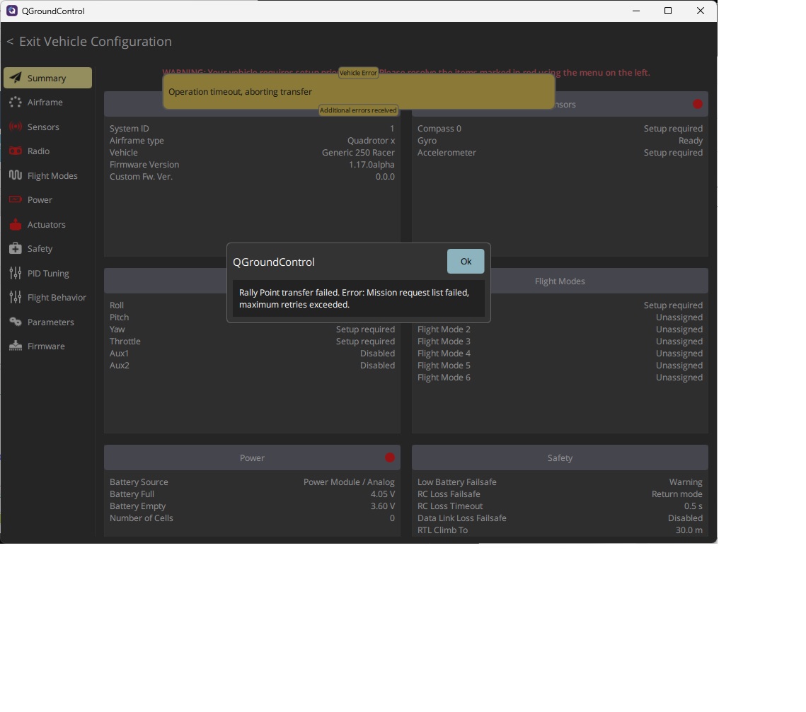

I am currently using the Holybro KakuteH7 as reference board. I have remapped the pins in the px4 project, successfully built the project and flashed the firmware (both main and bootloader). I can calibrate the sensors in QGroundControl and was able to read the measurements using MAVlink cli. But I keep getting these timeout errors:
I suspect it has something to do with the Sequre FC using the M25P16 flash memory and KakuteH7 using an SD card. Does anybody have any experience porting over the M25P16 code from let’s say BetaFlight or similar firmware to the PX4 project? If so, some guidance would be greatly appreciated! Or does NuttX already have driver support for that flash memory part? If so, could someone with experience please explain how to configure the driver to support the flash memory?

There are two other abnormal board behaviors that I would like to seek help with:
  1. The “reboot” command in MAVlink will brick the FC. Had to do a mass chip erase and re-upload the bootloader and application code to get the FC back again.
  2. Inability to upgrade the existing custom px4 firmware through ‘Vehicle Configuration’>’Firmware’. Nothing will show up unless there’s only bootloader on it. So had to do a mass chip erase and re-upload the bootloader and app code everytime changes have been made to the code.
