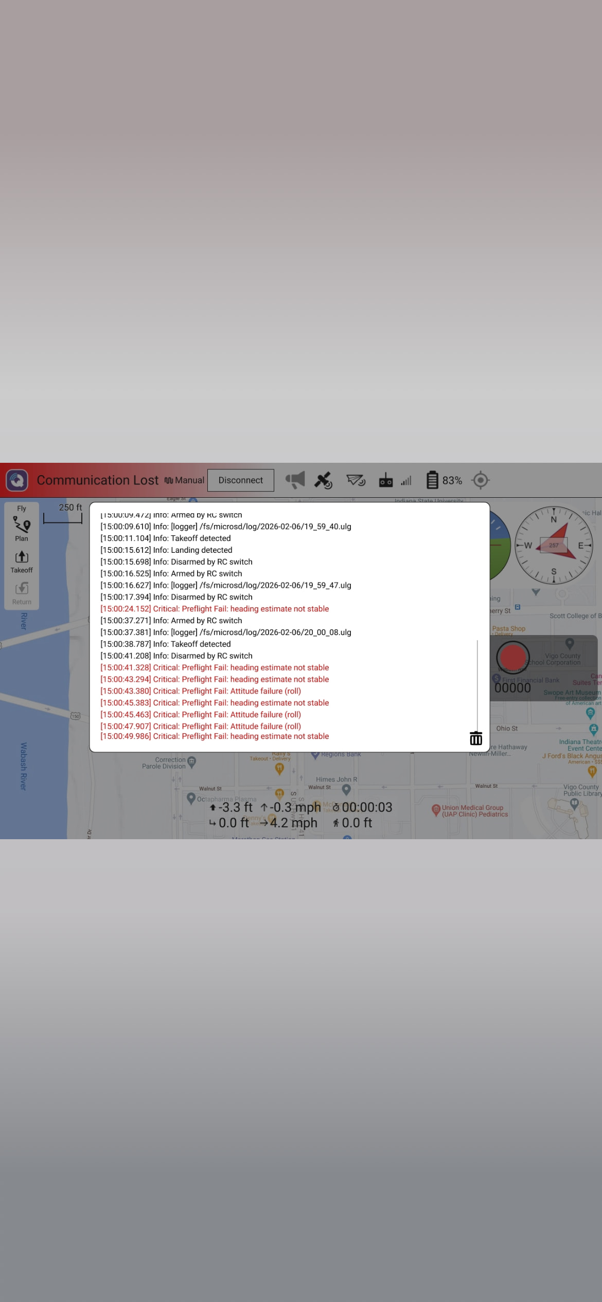

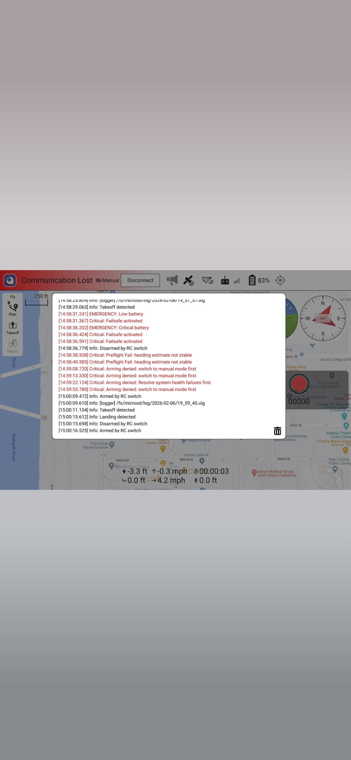

I have had a hard time clearing problems causing poor system health, and among that my drone was able to arm but would always takeoff and roll into the ground, any ideas?
Hi there!
Please do not be surprised if you arm a drone with Health issues and it misbehaves. That is exactly the reason why we have these checks! Fix these issues first:
  • Battery is too low, or wrongly configured
  • Use an allowed mode for takeoff (think Stabilized, manual, position, etc. )
  • All other issues marked in red
For more debugging, a log form boot would be helpful
