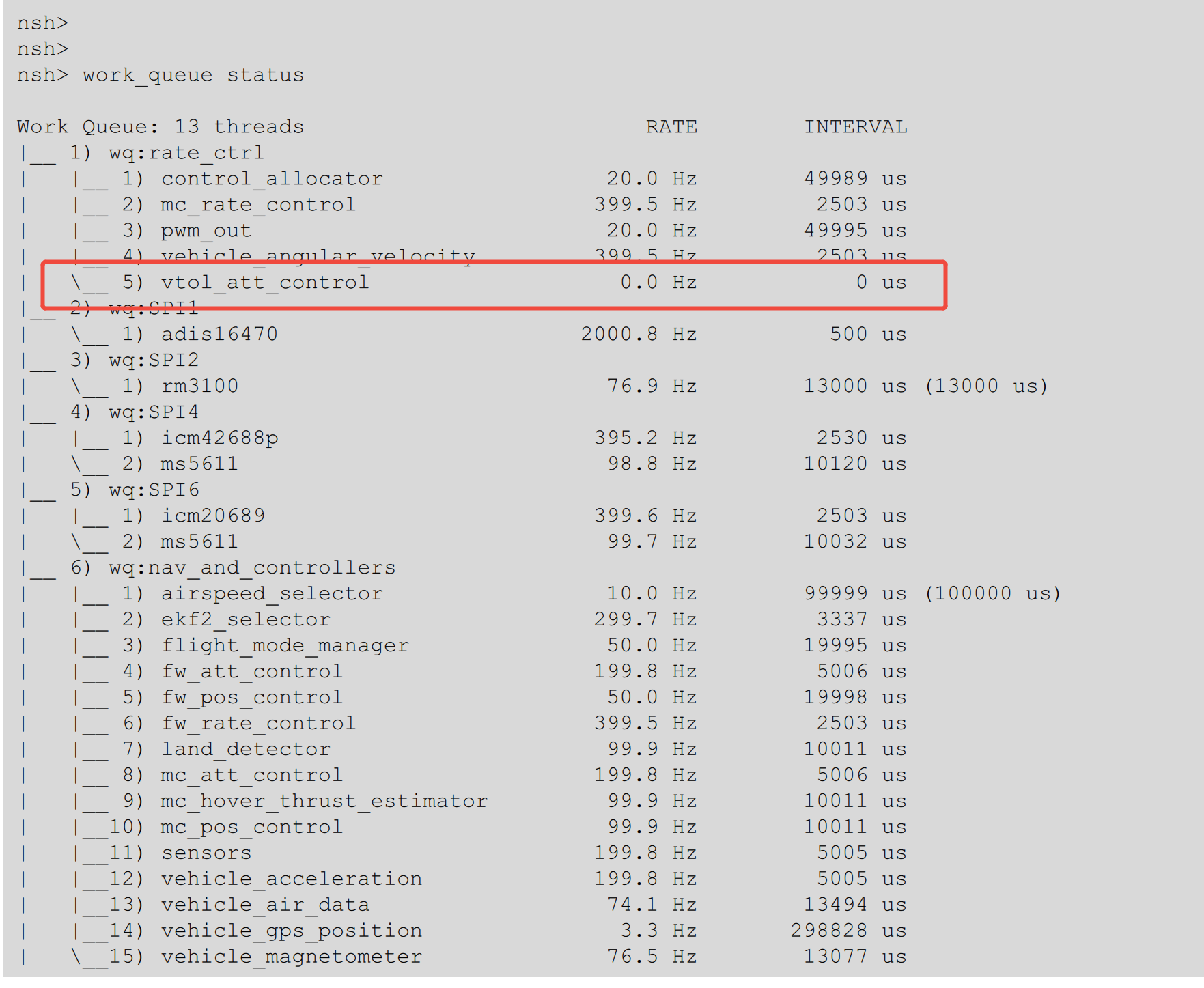

I have reproduced the issue when I test on the ground. It looks like vtol_att_control not running .
The steps I took to reproduce the issue are as follows:
  1. Use the remote controller to switch the mode to Manual Mode.
  2. Arm the vehicle in Multicopter Mode.
  3. Use the remote controller to switch to Fixed-Wing Mode and increase the airspeed.
The issue cannot be reproduced every time, and after it occurs, switching to Attitude Mode using the remote controller will make the issue disappear.
