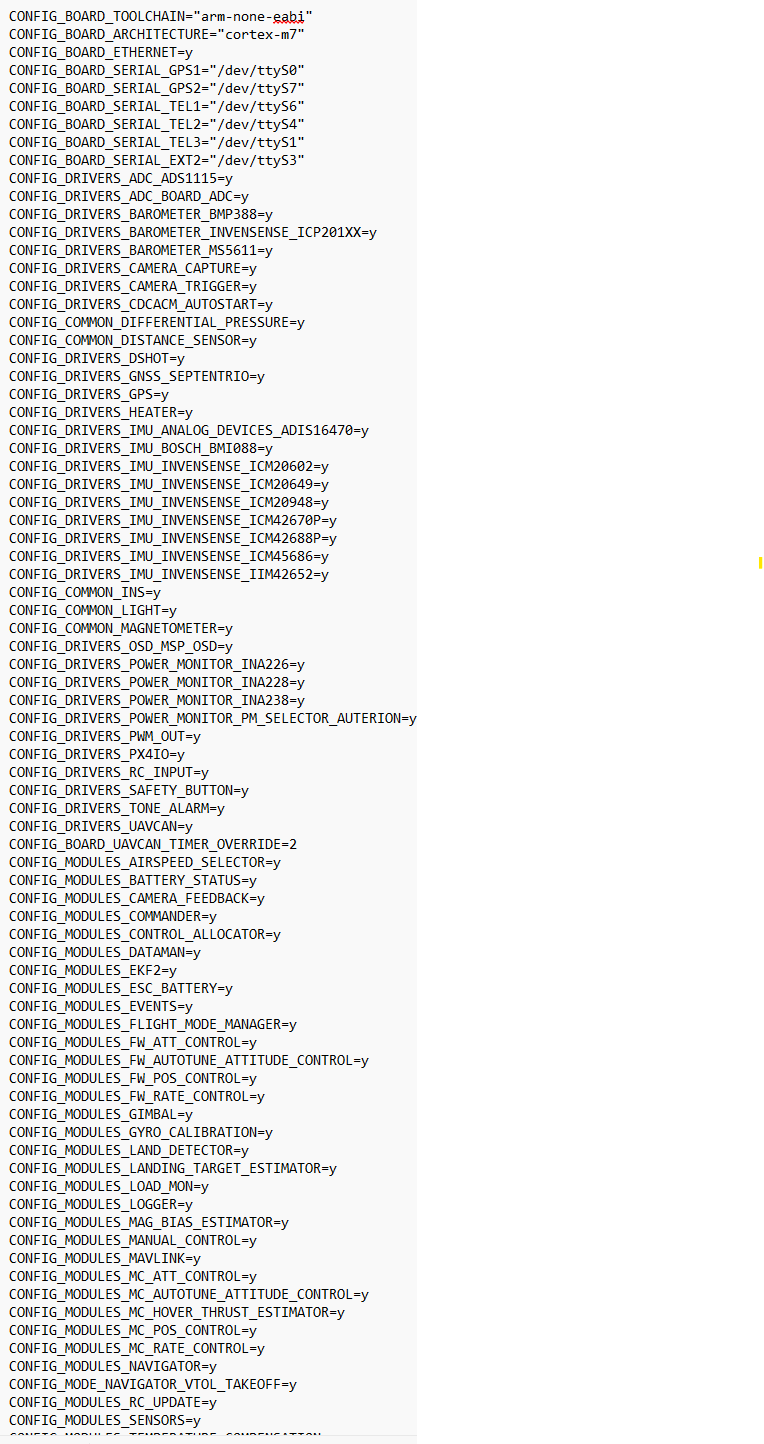

Went down the rabbit hole of firmware, and opened the default.px4board file for my board (fmu-v6x, attached picture), but its not clear to me what entries are needed for each serial port. There is a “CONFIG_BOARD_SERIAL” entry for GPS1/2, TEL1-3 and EXT2 (which I think is UART4?). But only a “CONFIG_DRIVERS” entry for GPS. Do I need config driver entries for the port I intend to use?

OK, so Pixhawk 6X configuration includes the CONFIG_DRIVERS_RC_INPUT=y but not CONFIG_COMMON_RC=y. What that means is that the individual drivers configured by RC_DSM_PRT_CFG are not present by default in this build.
So you’ll be using the RC input module, which should be already running on the RC port of your device - you can check its param, and also RC_PORT_CONFIG try getting its status.

Okay cool! Further debugging here, with ultimate goal of ensuring the DSM port is configured and running the right driver. Before my last post I modified the firmware to set CONFIG_COMMON_RC=y, which is why I have RC_DSM_PRT_CFG as a modifiable parameter.
  • I modified RC_DSM_PRT_CFG to target EXT2 port (no idea if this is the RC or DSM port, but its /dev/ttyS3), and am getting the same output as you when running “dsm_rc status”. So thats good.
  • I also changed RC_PORT_CONFIG to EXT2 as well (as you instructed). When I ran “rc_input status”, it says not running. I then did “rc_input start -d /dev/ttyS3”, and its searching for signal, but is rotating through all the protocols. RC_INPUT_PROTO is not a parameter I see for some reason.
Should RC_PORT_CONFIG be searching different protocols, given I have RC_DSM_PRT_CFG set to the same serial port (EXT2)? What is EXT2 exactly, is that the DSM port or the RC port? By board has a 3-pin DSM port with a JST ZH connector and a 3-pin RC IN port for a dupont connector.

Interesting point is that I dont see any serial port option for my DSM port. Not sure if I need to configure that in firmware. But if it does need to be configured in firmware, documentation should be updated.
G’day, it’s my job :-).
Each board “should” have a preconfigured bunch of ports, and these should be offered when you assign a serial port. For RC, taking the current SBUS config RC_SBUS_PRT_CFG, that mapping would be the 300: Radio Controller.
The mapping is set in the board configuration, which I have documented for most boards in a section like Holybro Pixhawk 6C | PX4 Guide (main)
You will note that this does NOT show the mapping for Radio Controller, because the algorithm I use for working out the mapping doens’t cover that.
Upshot, it is likely your board is missing something that offers you that port.
