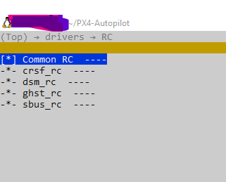

The board configuration seems to include crsf

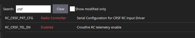

Qground Control, CRSF is enabled and set to RC (USART6, tty5)

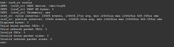

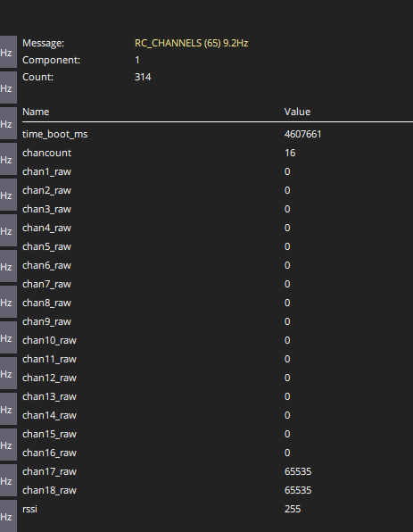

  • RC calibration does not show any stick or switch movement, but doesn’t tell that the RX is not connected, hence, I conclude it detects the RX (because if I disconnect it, I get a “connect RX first…”.
RC Channels:
CRSF_RC status:

Interesting In the above post is the rc_input start cmd used; but shouldn’t it be crsf_rc start instead?

Can you share your param file?
Sure, attached - oh it seems like that neither .params nor .txt can be uploaded.
ark_default_params_crossfire_enabled.pdf (271.0 KB)

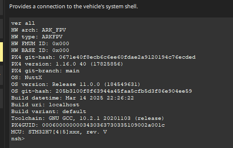

Can you try main? Can you also try a param reset? Make sure you save your current param set so that you can restore it later if you need to.
Dear Dekejahl, may I ask you what is meant with “main”? I can try a paramter reset.
The PX4 main branch
Sure. I can compile the latest PX4 for the ARK fpv board if that is meant.
