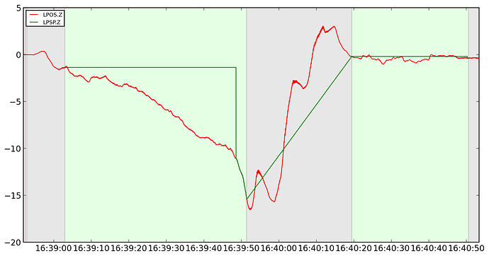

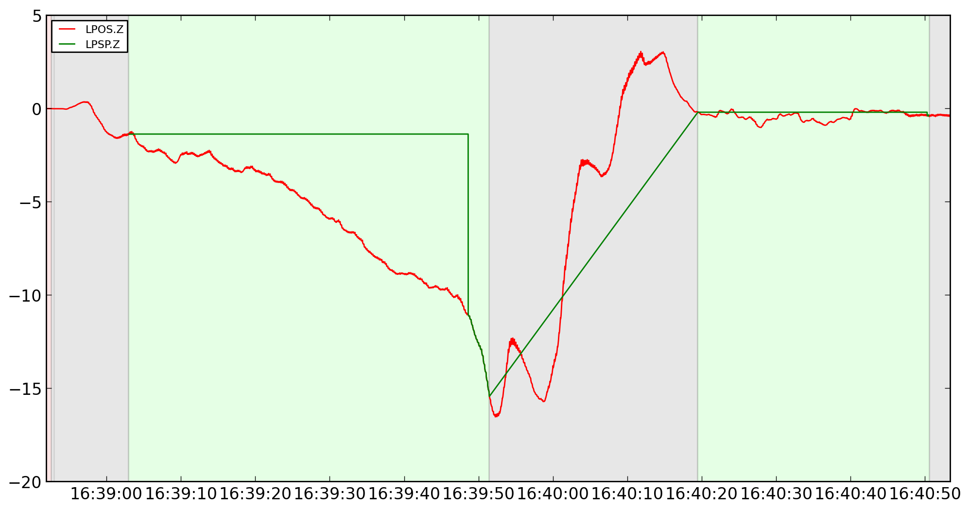

I have been flying with the latest master 1.6.0, using LPE on my quad. I have been trying to utilize lidar-lite v3 and optical flow sensors as well as GPS to achieve stable hover on position control and auto.hold modes. On the first two flights, I have tried to use lidar-lite v3 and optical flow together and here are the results:
  1. http://logs.uaventure.com/view/buCJ8RZ57B3Kg7ZcXeuiy8 as you can see in this log, when I switch to position control mode, although quad’s positon setpoint on z axis barely changes it gained altitude in a brief moment where I had to take back control by switching back to stabilized mode. I can confirm that the quad actually gained altitude and it’s not a faulty sensor reading or anything. We can confirm that copter gained altitude by looking at many graphs such as actuators and many more. (mode change sequence is as follows: stab-posctl-stab)
  2. http://logs.uaventure.com/view/JyNaZdpgQWoa8C7TbX4o3V I have also tried the same thing as log 1. I have tried to switch to position control 6 times in this log, and in almost every trial I had to immediately switch back to stabilized mode because the copter again shoots up in the air immediately when I switch to position control (mode change sequence is as follows: stab-posctl-stab-posctl-stab-posctl-stab-posctl-stab-posctl-stab-posctl-stab)
  3. http://logs.uaventure.com/view/o8fTZufPqLz2tnhWsC4hzP On this flight, I have disabled the lidar lite v3 parameter, as well as disconnecting the optical flow sensor, thinking that my altitude problems might be caused by sonar or lidar that the LPE have been fusing into my altitude reading. But no luck, copter kept doing the same thing. This time, I’ve decided to use auto.hold mode in order to see maybe it would make a difference. This time, there was no immediate shoot up but the altitude was slowly diverging again in the same direction, upwards. (mode change sequence is as follows: stab-hold-stab-hold-stab)
  4. http://logs.uaventure.com/view/aNqoNg8rrnhVX4dtR7xH2J This time the sequence is as follows stab-hold-posctl-stab and we can see that although the position setpoint on z axis stays the same, it starts the diverge again in the negative-z direction towards the sky, and then also the setpoint changes which I suppose is as a result of this z error over time.
  5. http://logs.uaventure.com/view/ssmkwAQ9thgytJLHzqbSe This time the sequence is as follows stab-posctl-stab and it is clearly observed that although the position setpoint on z is constant, the altitude readings diverge from this number over time, causing me to switch back to stabilized mode to recover the quad.

is this problem only observed in 1.6.x or before?

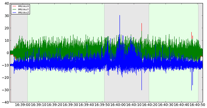

z altitude hold problem I faced too many times and tried out some pid tunings but all tries were ended up successfully by chabging hardware (pixhawk), it is usually a baro drift, i would check the foam of barometer, or try same configuration with only changing pixhak, also it may be because of accZ meaning a vibration. u may use vibration dampener, also check accZ values during flight and no arm situations. in disarmed, it should measure gravity, in flight, it should not exceed 15 m/s^2. if so, u have a vibration.
Hi basic problem is you have very high level of vibrations
So estimator have to deal with much noise, and fails.
Here you can see vibrations on my copter(250class racer, pixracer hard-mounted to the frame)
yes, meaning the z axis vibrations. vibration dampener greatly improves the performance.
