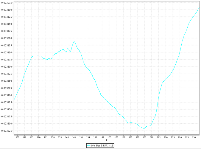

I am using master v1.6.0, and went for couple of flights with my F550 hexacopter frame. I did around 6 flights. Five of them went fine in alt hold and poshold modes. However, in the last one, I faced the issue of not being able to bring the copter down in altitude hold mode. I was pulling the throttle all the way down, but the copter would respond to that as it should. It was mainly staying hold and drifting up slowly. I was not using any range sensors. Only baro and gps for altitude estimation.

My hypothesis is that IMU vibration or irregular EKF updates is causing an unstable bias estimate and the estimated vertical position and velocity error to grow to a value that prevented the copter from descending. Changes to the estimator to reduce the likelihood of this occurring have been made since v1.6.0 was released.
The position controller is vulnerable to vertical velocity estimation errors because it does not track a position set-point when the user demands a climb or descent and the users demanded descent velocity demand is limited when below an altitude threshold above takeoff point.
Changes to the estimator to reduce the sensitivity have been made since v1.6.0 was released, but the position control loops still have the vulnerability. Your short term options are to improve vibration isolation and turn off IMU accel bias estimation by setting EKF2_AID_MASK = 5, however make sure you have a recent accel calibration if you do change this parameter.

Here is the Z accel delta velocity bias estimates:

Thanks, Paul, for the explanation. I was actually questioning the IMU vibration, but I don’t know which levels of vibration are acceptable.Currently, I am using damping pads (4 pieces under 4 corners of Pixhawk). Are there better vibration dampening methods?
With the same exact setup, I flew last night couple of flights, and I did not get the issues I faced. So I am trying to understand when this happens! If it’s vibration, then it should be about the same level in almost all fights as I did not change the setup, no? Also the wind conditions in all flights were about the same.

The effet of disabling bias estimation will be minimal if the IMU accels are calibrated with the board at the same temperature it will be during flight.
I use soft latex foam for the pixhawk isolation https://hobbyking.com/en_us/anti-vibration-foam-orange-latex-190mm-x-140mm-x-6mm.html to reduce the natural frequency of the pixhawk on the mounts. Alternatively you can reduce the amount of foam pad area or add mass to reduce frequencies which can be achieved by placing the pixhawk on a plate that is then isolated.
Also check that that all wiring to the pixhawk has enough loop or bend so that it is not transmitting vibration.
