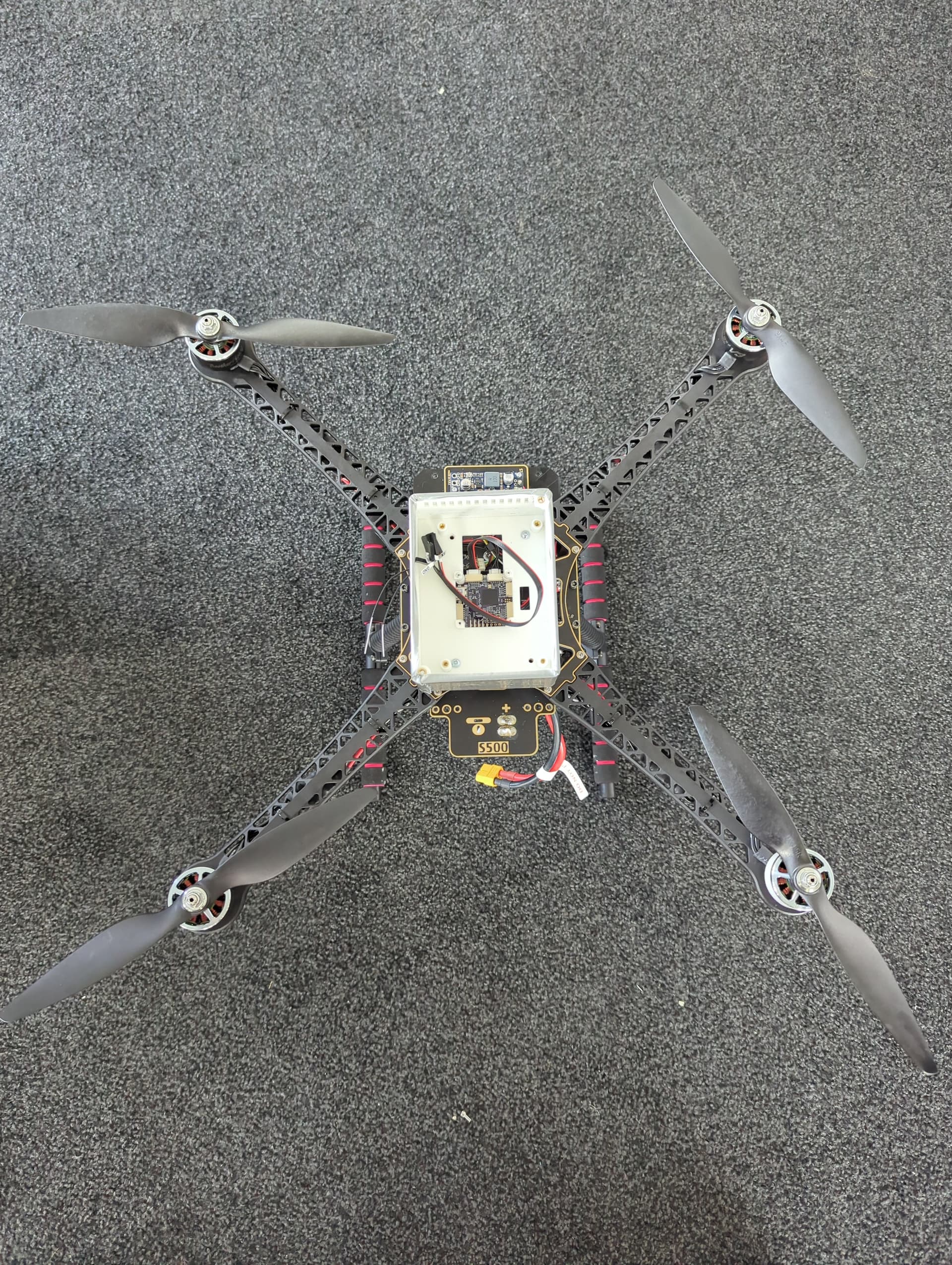

Kindly send a picture of the drone including the propellers .
Thanks for helping out! This is a picture of the quad:

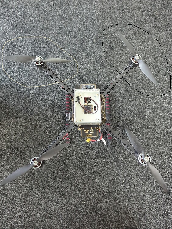

Your propellers are installed upside down !! :slightly_smiling_face:… you cannot turn the propellers upside to make it clockwise or vice versa …!!

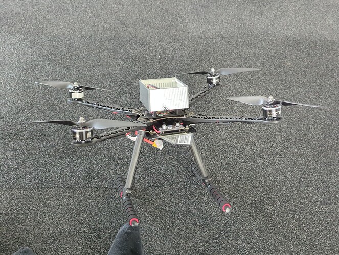

I see the lighting and propeller texture is misleading and makes it look odd. But I can reassure they are mounted correctly. See attached picture:
Can you advice what is the brand and the size of the propeller. Normally these are sold for fixed wing push configuration models. Did you buy them in pairs like CCW and CW ?

@sibujacob I bought these propellers in CW and CCW configuration, identically to the drone, that is working. They are 9 x 4.5 inch propellers.
You may need to increase the size of the props to 11" for an S500 drone. 9" may be small to create the lift .

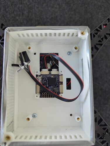

@lordreas These are indeed abnormal readings for the state estimator. I will look into that with more detail, I would need some time to study it properly. For the throttle output, have you already tried to swap the Pixracer with the Pixracer Pro into the current setup and see if the issue is still there? Also, the Pixracer Pro may be unable to communicate with the ESC. I’m wondering if you could please share the output of dshot status. In the meantime, I will try to schedule a space to use my measurement tools to see if the current firmware/configuration is causing this issue.
