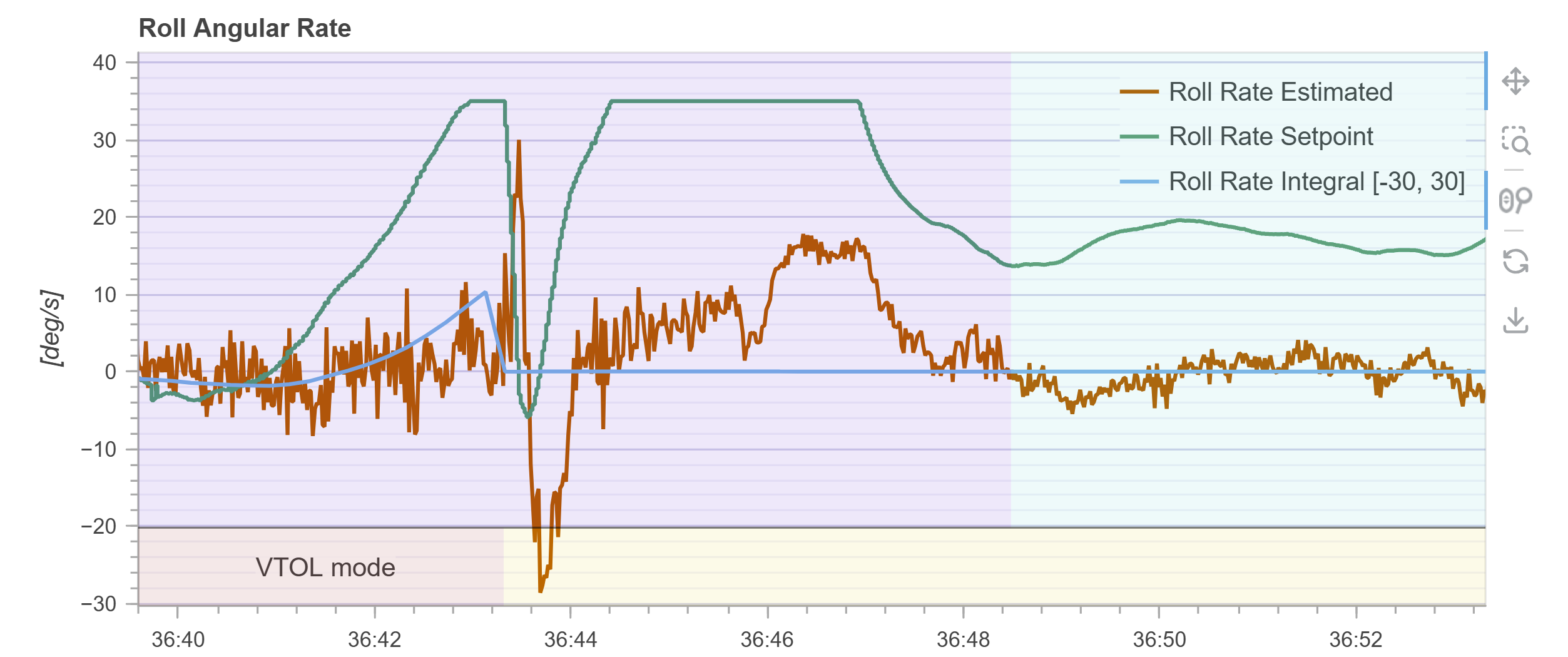

In previous flights (https://drive.google.com/file/d/1hA-IeU19F-2g4MGiAY5xYAbBhN0dhI7P/view?usp=drive_link), this control method worked reliably. The aircraft was able to follow the commanded velocity setpoints in fixed-wing mode without any issues. The successful log figure is shown as follows:

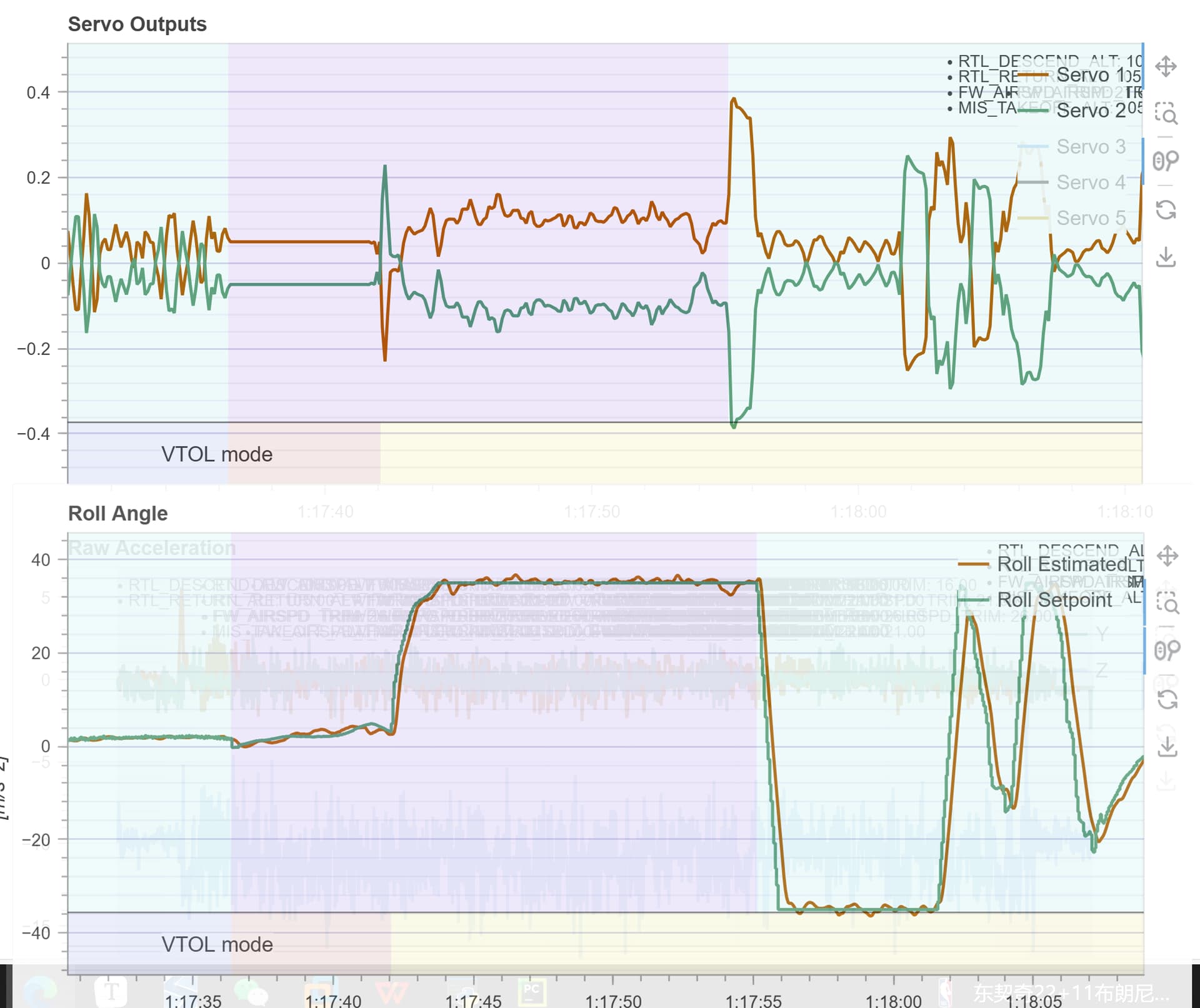

However, in this particular flight, immediately after switching to Offboard mode, an abnormal behavior occurred:

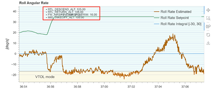

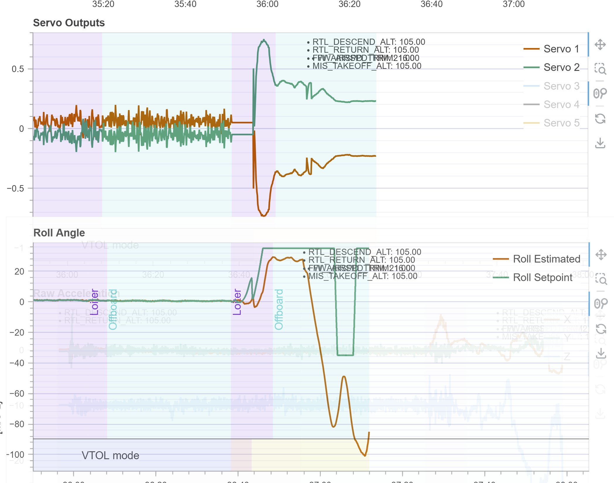

the fixed-wing roll_rate could not track the commanded values, leading to increasing control deviation and eventually causing the vehicle to lose control and crash. The failed log figure is shown as follows:

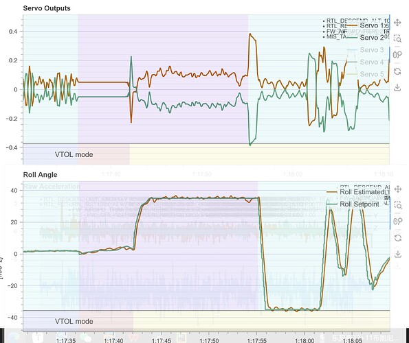

At the moment, I am unable to determine the root cause. Possible suspects include:
  • Aileron or other actuator saturation/abnormal response in fixed-wing mode
  • A malfunction or instability in TECS (Total Energy Control System) during Offboard control
  • A control-mode or attitude-controller inconsistency introduced during the VTOL transition
I would appreciate help from the PX4 community in analyzing what might have caused the roll_rate tracking failure, and what further diagnostics or tests I can run to narrow down the issue.
@sfuhrer @Jaeyoung-Lim

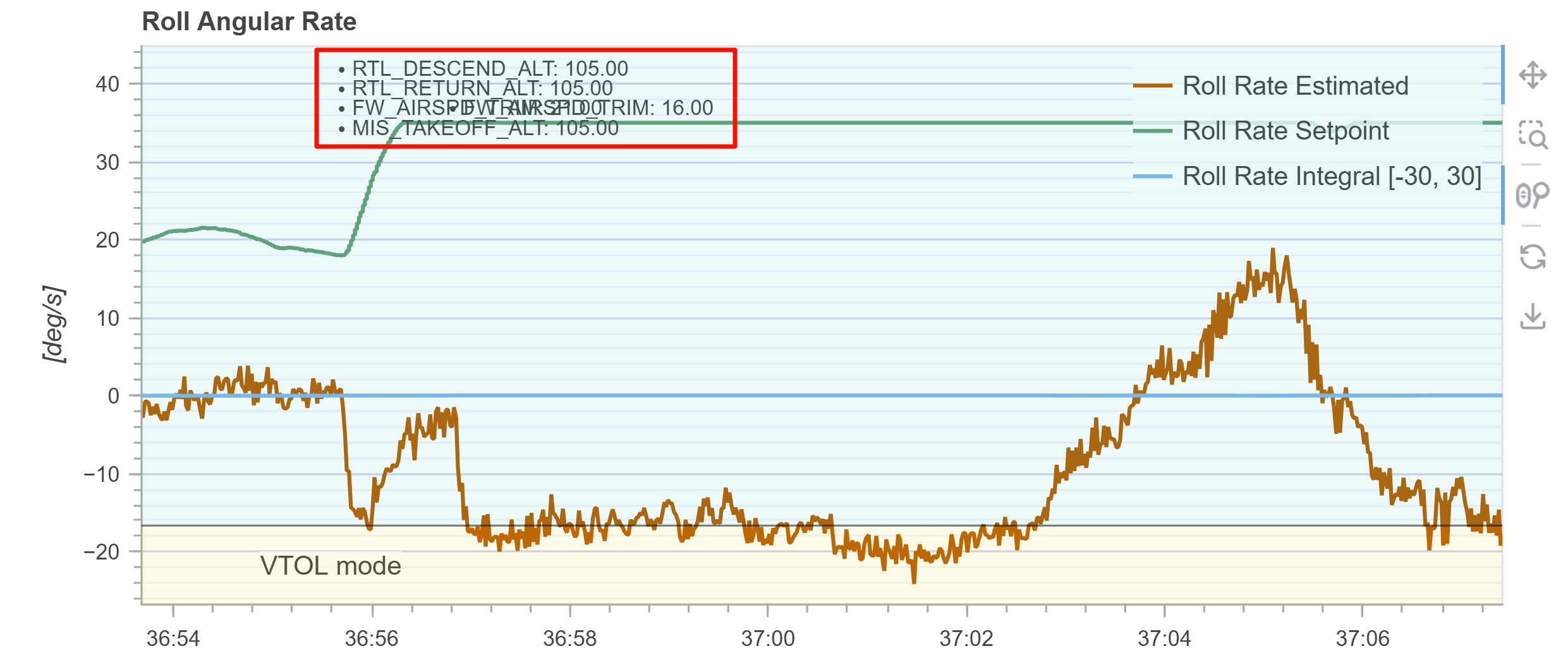

It’s important to note that I have also encountered this phenomenon multiple times. I believe this issue deserves attention from the PX4 community. @Jaeyoung-Lim
What kind of hardware failure could cause the roll rate and its setpoint to maintain a consistent deviation for an extended period of time? And why does setting the parameters (especially the FW_AIRSPD_TRIM) seem to exacerbate this deviation?
