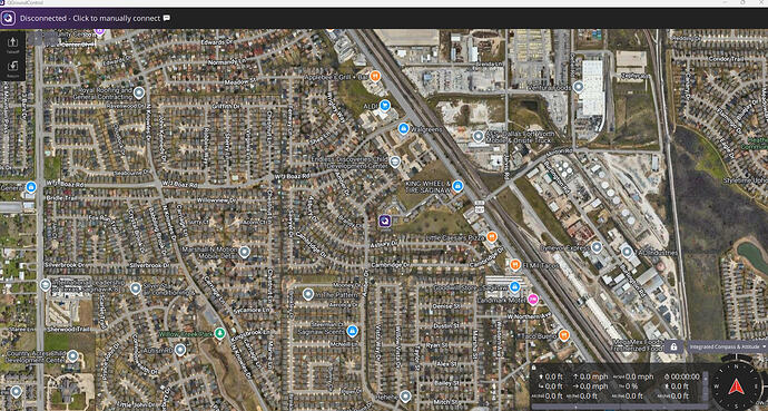

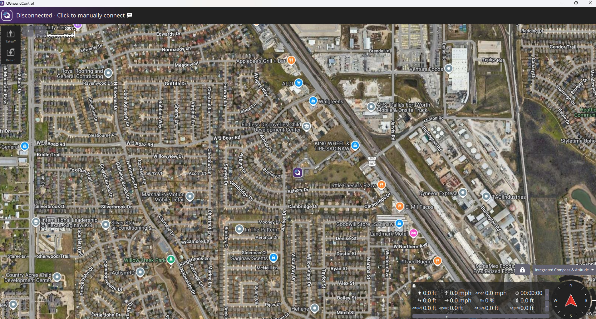

I am now looking at QQC. It looks like this:
It does NOT autoconnect.

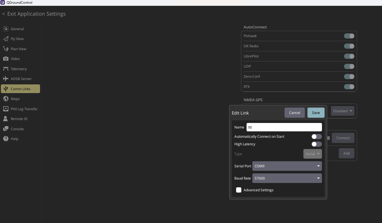

So I make a new connection:
I know COM 9 is correct and I know 57600 baud is correct. I also know the NET ID is 26 on both radios (see above explanation)

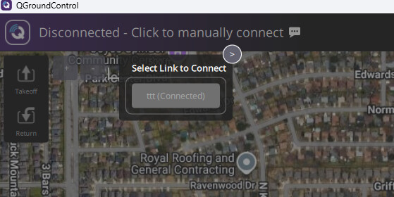

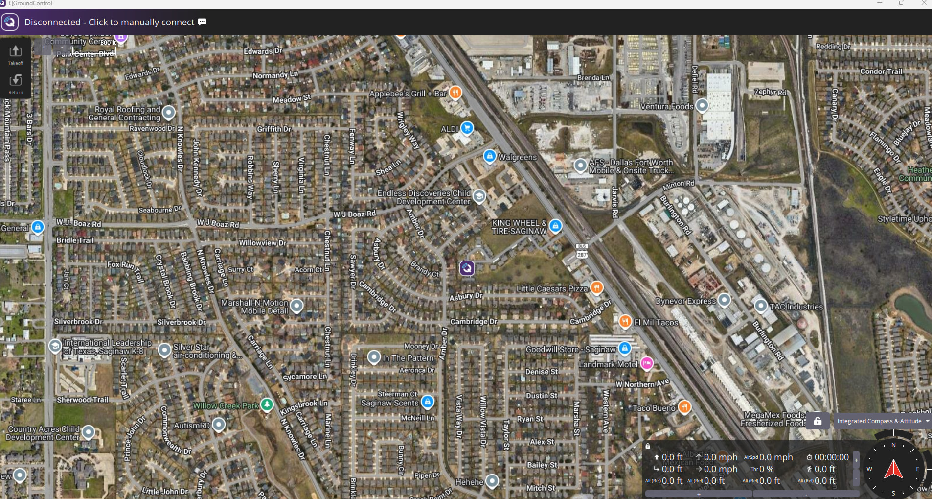

I manually make the connection (even though Sik Radio AutoConnect is ON) and I see this:
I do not get a connection to the fixed wing plane, why not?
Solved this by doing this:
Configuring TELEM2 in QGroundControl
  1. Connect your PX4 vehicle to QGroundControl.
  2. Go to Parameters and search for MAV_1_CONFIG.
  3. Set MAV_1_CONFIG to TELEM2.
  4. Search for SER_TEL2_BAUD (or MAV_1_BAUD) and set it to your desired baud rate (e.g., 921600 for companion computers, 57600 for typical telemetry radios).
  5. Reboot the flight controller.
PX4 does not come with any Telemetry port preconfigured to use telemetry, you must go into the parameters and set them up from the get go. I was not able to find the source that a google AI search was able to find in order to tell me how to set the parameters, i.e, the list of steps above.
