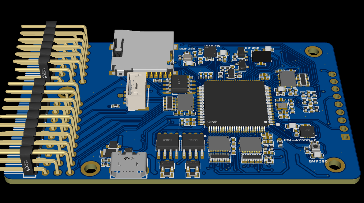

I’m developing a custom flight controller, based on the STM32F765VGT6 (1 MB flash, Cortex-M7) . Before production, I’d greatly appreciate your feedback on my schematic and design to ensure compatibility and reliability. Thank you for your time and expertise
Hardware Overview
MCU: STM32F765VGT6 Sensors:IMUs: BMI088 (SPI3, shared), ICM-42688-P (SPI1) Magnetometers: IST8310 (I2C1, shared), MMC5983MA (SPI2) Barometers: BMP388 (I2C1, shared), BMP390 (I2C2) Storage: FM25V01A-GTR (FRAM, SPI3), MicroSD (SPI4) Connectivity: 8 PWM outputs, 2 CAN buses, UARTs (telemetry, debug, SBUS), TXS0108ERGYR level shifters Schematics and pin assignments are in my GitHub:

Just one comment. 1 MB flash sounds like a bad idea as it will be a challenge to fit everything that you need in. 2 MB would be my recommendation.

So, personally I will opt for a different MCU…more capable in memory, just remove the IC for sbus coz F7 and H7 can handle sbus, are you opting for JTAG or DFU for flash the MCU? I think you don’t need add two magnetometers on the board coz usually the internal on the PCB it’s affected by vibrations and emi. Add to the boot pin a 10k res connected to GND and check the correct value about the resistors for the current and voltage sensing..

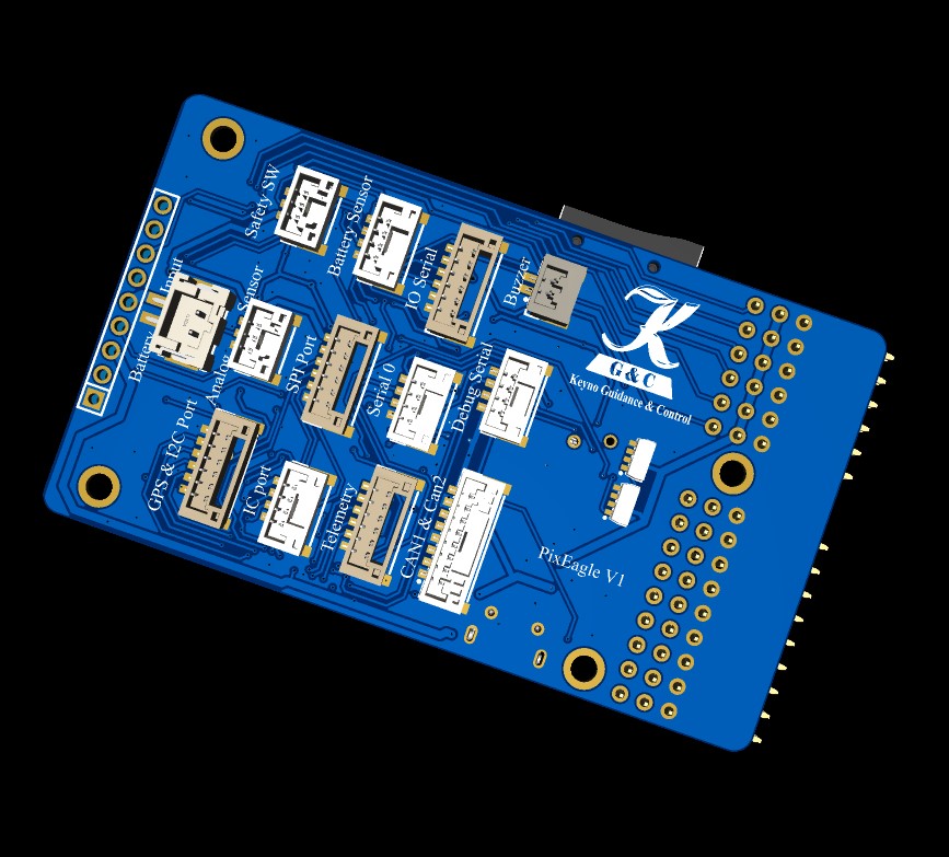

Second, I’m having trouble with the pin arrangement for my connectors. Some GPS modules, for example, have a separate I2C port, while others have a single connector that includes both serial and I2C. Is there a standard or recommended way to arrange the pins? For instance, should all serial ports be arranged in the same order (e.g., 5V, TX, RX, and GND)?

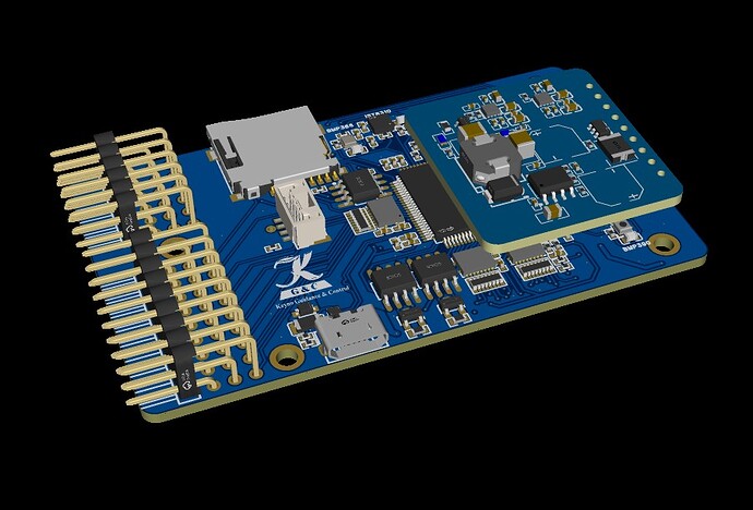

I’ve also moved all my buck converters and LDOs to a separate board to improve signal integrity, as I’ve found the ESC power supply to be unreliable and noisy.

Good day, you can remove the U74LVC1G14G IC…no needed in F7 and H7 MCU, you can add only a 220R as you are working with a TIM channel. About the connector for GPS, you can do in this way a JST-GH 6 pin…5V-TX-RX-SDA-SCL-GND.
Check also a good pcb stackup…i think due the density you must use 6L.
Hi Dave I updated the MCU to the H7 series and other comments that you mentioned. Would you please check my last schematic
pixegle schematic.pdf (908.9 KB)
So.. MCU VDD pins rquire caps like datasheet, all SPI CS pin must have a 10k pull-up resistor, no need analog sensor, ive some concerne about your SBUS design, in can transceiver miss a 120R. The schematic its caotic.
I recommend starting on an easy project.
