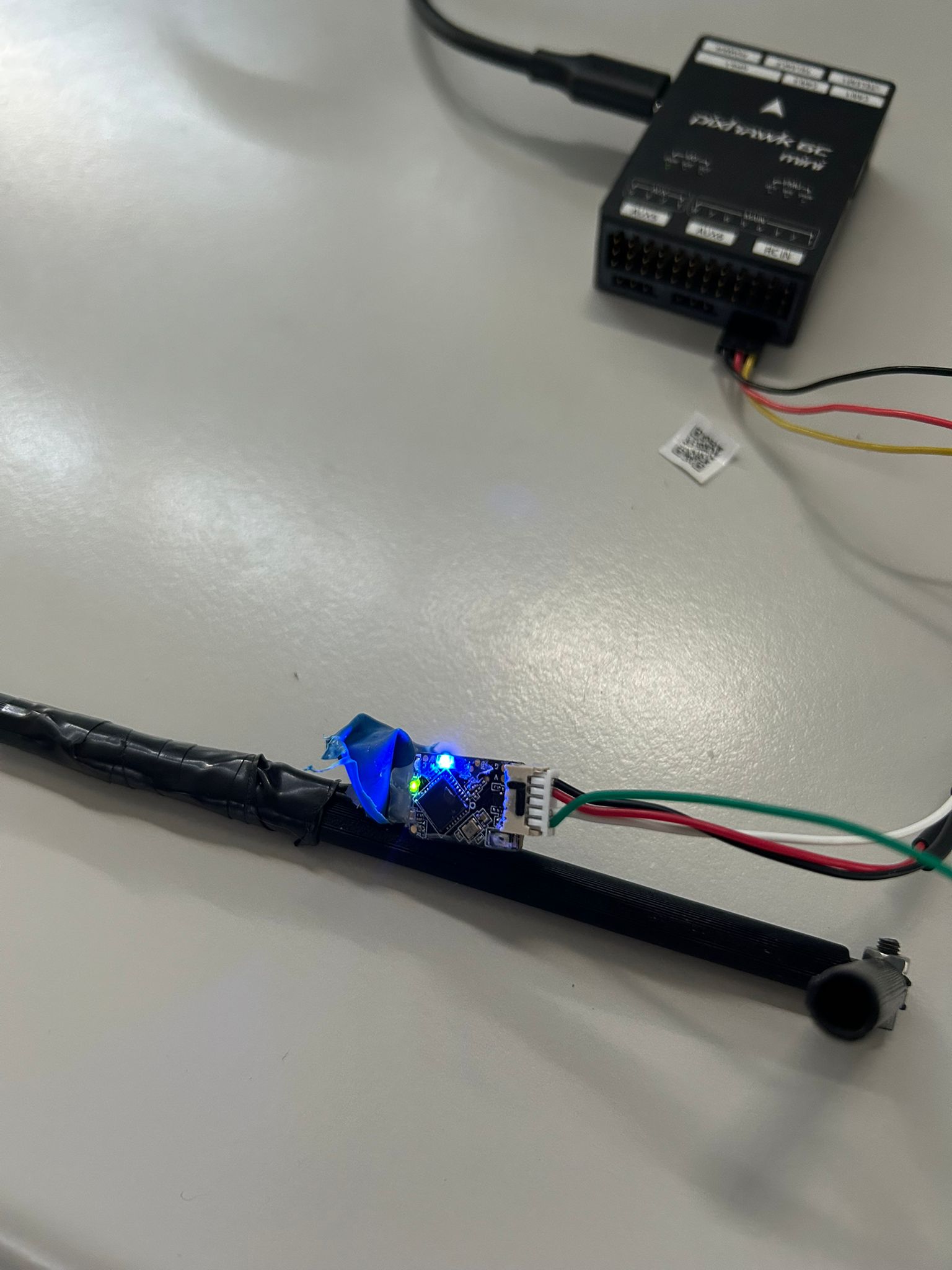

Hoping someone can help me out. I have a Pixhawk 6C Mini running PX4 and I’m trying to connect an FrSky R-XSR to it.
The R-XSR is bound correctly to my controller ,I have a solid green LED indicating a stable link, and a solid blue LED which (per the manual) means it’s set to SBUS output mode.

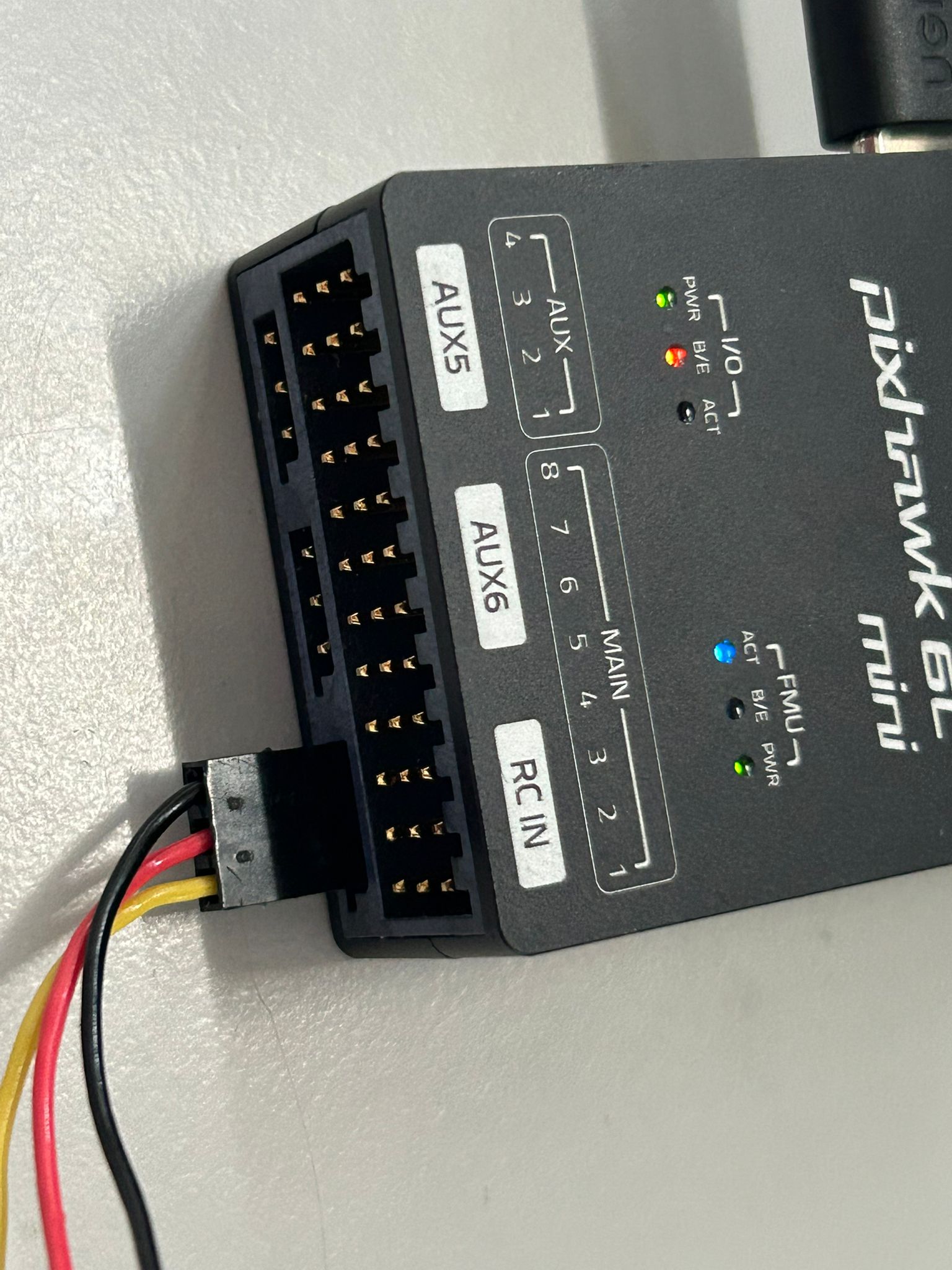

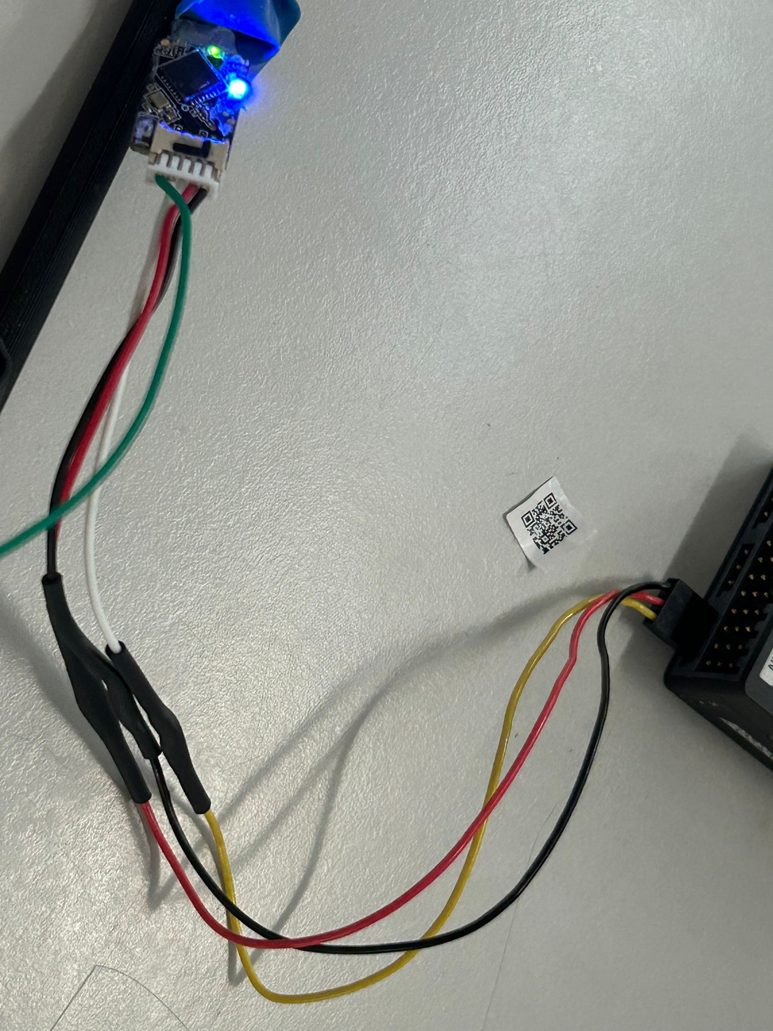

The receiver is wired to the Pixhawk’s RC IN port with: SBUS-OUT → signal, +5V → VCC, GND → GND. I’ve verified continuity end-to-end on the cable with a multimeter, no shorts.

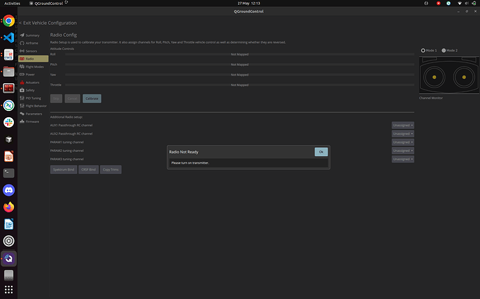

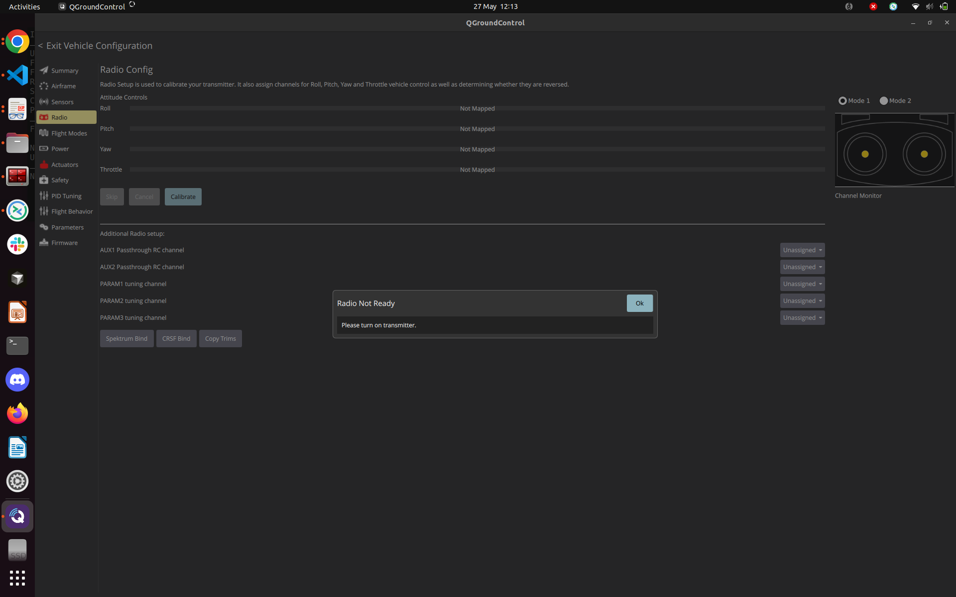

The issue: in QGroundControl, the Radio setup page shows “Radio Not Ready - Please turn on transmitter,” and no channels respond when I move the sticks. The transmitter is on, the receiver LEDs stay solid throughout.

Thank you for the feedback! The thing is that the transmitter used to work with another FC, so I am worried that the problem might be the pixhawk itself

This is my hypothesis and tell me what you think about it. So I managed to make it work with another receiver which is using the ACCESS protocol instead of the ACCST D16, could it be possible that pixhawk doesn’t support ACCST D16? Maybe it’s written somewhere but I lost the information.
