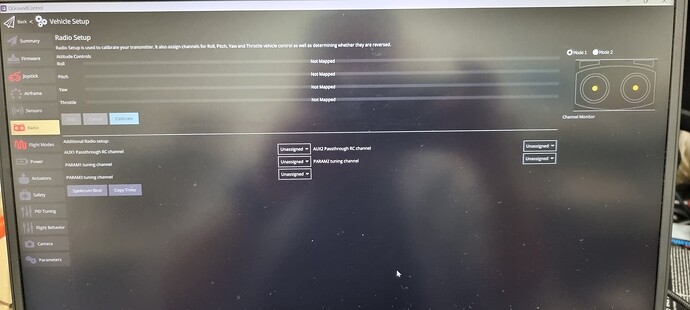

Hi everyone,
I’m currently trying to connect my RC system (Transmitter: FrSky X9 Lite S, Receiver: FrSky Archer GR8) to a Pixhawk 6X flight controller mounted on the Pixhawk Mini Baseboard. Here’s the setup and the issue I’m facing:
  1. Setup Details:
  • Pixhawk 6X firmware: PX4 Pro v1.15.2.
  • Receiver firmware: Archer 2.1.14.
  • Transmitter firmware: ISRM-X 2.2.10.
  • The receiver is successfully bound to the transmitter using the ACCESS protocol.
  • Receiver is powered with 5V from a BEC.
  • SBUS OUT and Ground from the receiver are connected to SBUS IN and Ground of the RC port on the Pixhawk Mini Baseboard.
  1. The Issue:
  • Using QGroundControl, the firmware flashes successfully, and other features appear to work fine.
  • However, during radio calibration, no signal is detected in QGroundControl or Mission Planner.
  • I verified the SBUS signal using an oscilloscope on the RC port’s SBUS IN and Ground pins and confirmed a valid SBUS signal is present.
  1. What I’ve Tried:
  • Tested with another receiver (FrSky RX6R), but the issue persists—SBUS signal is visible on the oscilloscope but not recognized by the Pixhawk.
  • Simulated a PPM signal using an Arduino Uno, with the same result: valid PPM signal on the oscilloscope but unrecognized by the Pixhawk.
  • Accessed the MAVLink console in QGroundControl and ran rc_input status. It returned:
    nsh: sysinit: fopen failed: No such file or directory
    NuttShell (NSH) NuttX-11.0.0
    nsh> rc_input status
    INFO [rc_input] not running
  • Attempted to start the RC input service on the ttyS5 serial port (corresponding to the RC input port per Pixhawk 6X documentation), but after starting, it only shows:
    RC state: searching for signal: …
    This occurs even though the SBUS signal is visible on the oscilloscope.
  1. Additional Information:
  • I’ve attached photos to show the hardware setup, oscilloscope readings, and QGroundControl screens for reference.
Am I missing something here? Could there be a configuration step or compatibility issue I’ve overlooked?
Any help or guidance would be greatly appreciated!
Thank you in advance for your time and support.
