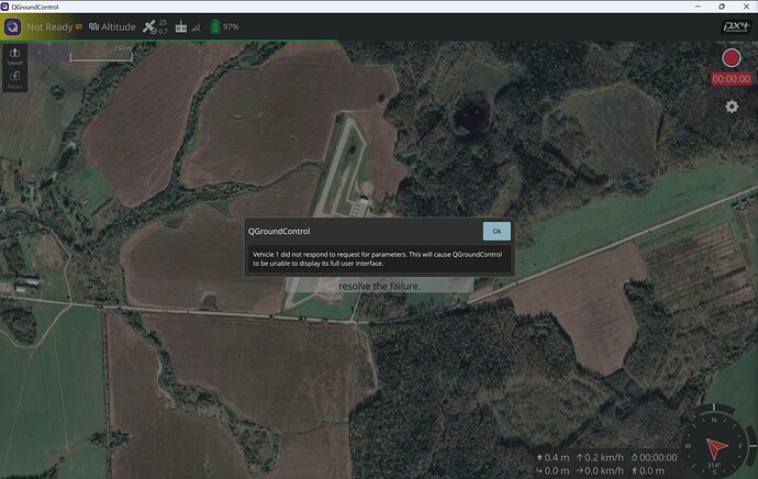

I’m using PX4 v1.16 Stable on a Pixhawk 6C flight controller and connecting QGroundControl (latest stable) through MAVLink Router.
My setup used to work perfectly, but recently QGC gets stuck on “Loading Parameters” and never finishes.

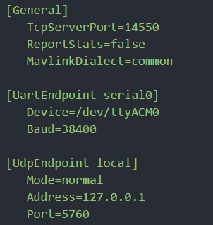

  • MAVLink Router Version: v4-15-g51983a4
What link/radio are you using? What’s the overall connection setup? What’s the mavlink-router config?
Radio: SIYI MK15
Connection Setup: TCP - IP Address - Port:14550
Mavlink Router Config:
Oh, are you sure MAVLink message traffic from PC to drone is working at all? When you send a command, does that work?
The issue occurs because the TELEM1 port is connected to the MK15 receiver via UART, while at the same time the USB port is connected to a Raspberry Pi running mavlink-router. It seems that this setup causes interference between the two MAVLink links.
Could you please advise how I can configure the system so that both connections can work simultaneously with MAVLink without conflicts? Also, which parameters should I set in the flight controller to achieve this?
Thank you.
Make sure the two QGC instances have different system IDs. You can configure that in the application settings.
