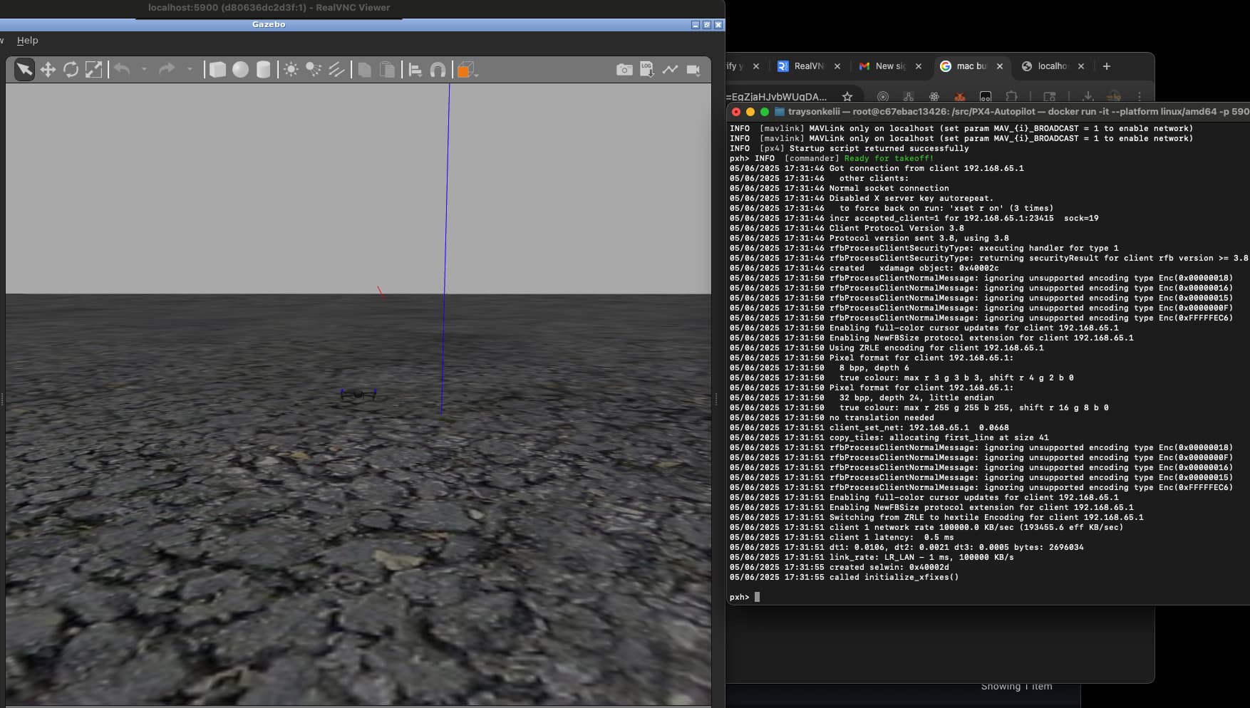

A work around that I can live with is through using docker to ensure the environment sets up nicely. I had to use the older Gazebo and VCN to view the GUI.

Then opening up a VNC Viewer I was able to view the drone.
