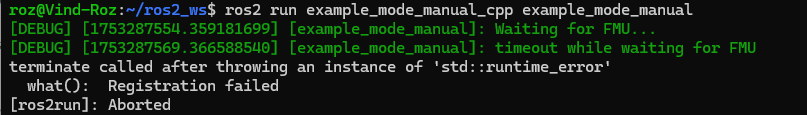

    When I run the built-in example_mode_manual_cpp node:
    ros2 run example_mode_manual_cpp example_mode_manual
    it logs:
    [DEBUG] [example_mode_manual]: Waiting for FMU…
    [DEBUG] [example_mode_manual]: timeout while waiting for FMU
    terminate called after throwing an instance of ‘std::runtime_error’
    what(): Registration failed
    even though other /fmu/out/* topics (like /fmu/out/input_rc) are being published normally.
    It seems the RegisterExtComponentReply is visible on the topic list, but the example never actually receives it, so doRegister() times out and the node aborts.

  1. Running the example without a translation node
    Output
    I can see /fmu/out/register_ext_component_reply in ros2 topic list, and other /fmu/out/* topics (e.g. /fmu/out/input_rc) are streaming correctly. However the mode never actually receives the RegisterExtComponentReply, so doRegister() times out.

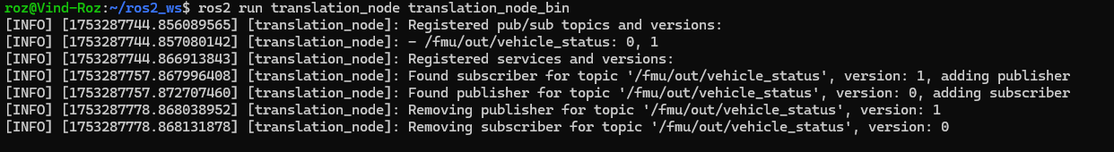

  2. Adding the translation node from PX4 v1.16.0-rc2
I followed the Tools/copy_to_ros_ws.sh script from the PX4 repo, built and sourced a fresh workspace containing:
  • translation_node (v1.16-rc2)
I then launched the translator:
ros2 run translation_node translation_node_bin &
Translation node logs:
[INFO] [translation_node]: Registered pub/sub topics and versions:
[INFO] [translation_node]: – /fmu/out/vehicle_status: 0, 1
[INFO] [translation_node]: Found subscriber for ‘/fmu/out/vehicle_status’, version: 1, adding publisher
[INFO] [translation_node]: Removing subscriber for ‘/fmu/out/vehicle_status’, version: 0

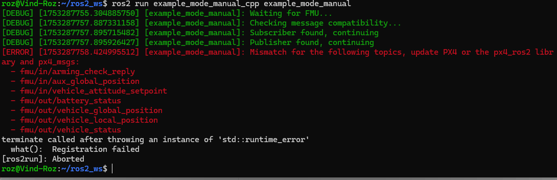

Re-running the example with translation
Output:
[DEBUG] [example_mode_manual]: Checking message compatibility…
[DEBUG] [example_mode_manual]: Subscriber found, continuing
[DEBUG] [example_mode_manual]: Publisher found, continuing
[ERROR] [example_mode_manual]: Mismatch for the following topics, update PX4 or the px4_ros2 library and px4_msgs:
– fmu/in/arming_check_reply
– fmu/in/aux_global_position
– fmu/in/vehicle_attitude_setpoint
– fmu/out/battery_status
– fmu/out/vehicle_global_position
– fmu/out/vehicle_local_position
– fmu/out/vehicle_status
Any guidance or suggestions would be greatly appreciated!

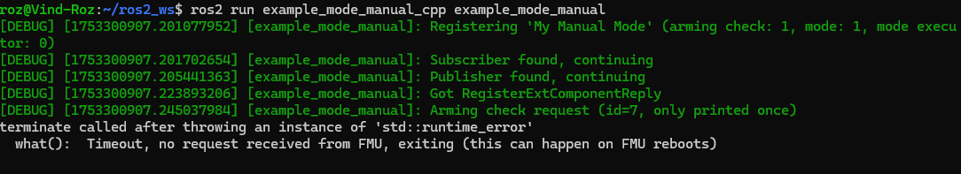

And finally i tried skip message compatibility check by inserting the setSkipMessageCompatibilityCheck();on px4-ros2-interface-lib/examples/cpp/modes/manual/include/mode.hpp
Then I got following error

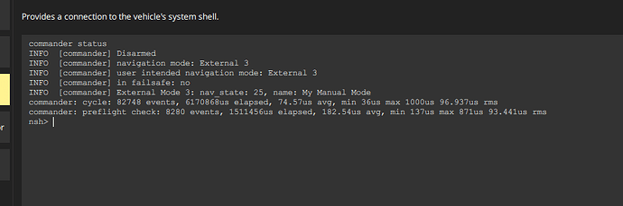

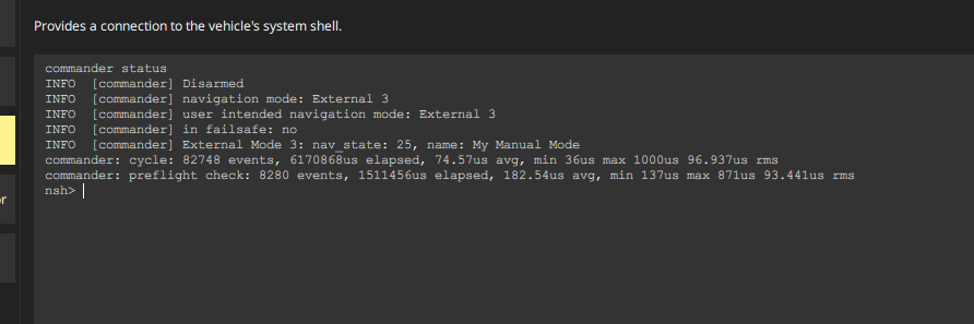

I’m now using PX4 v1.16.0-rc3 and the translation_node to bridge message compatibility. With this setup, my custom external mode (My Manual Mode) successfully registers, as confirmed via the commander status command:
External Mode 3: nav_state: 25, name: My Manual Mode

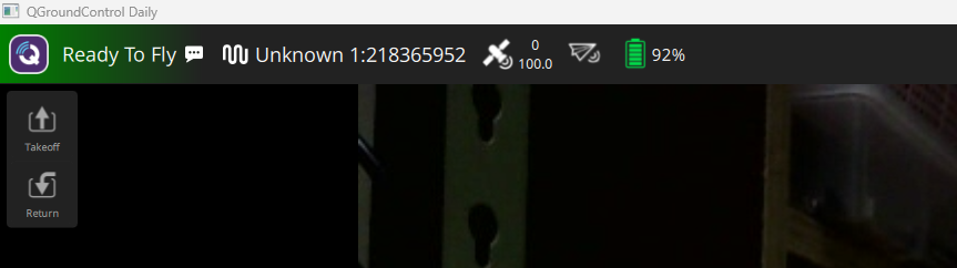

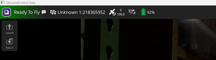

However, in QGroundControl, the mode still appears as:
Unknown 1:<some_id>
and this ID changes on each restart.
While the mode functions correctly and I can verify its registration through the PX4 shell, I have to manually check which external mode index it was assigned (1, 2, or 3) and then switch to that mode accordingly.
Is there any way to have QGC display the actual mode name (e.g. “My Manual Mode”) instead of showing “Unknown”?

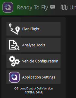

Tested QGS version : Daily Built as well as QGC 5.0.6

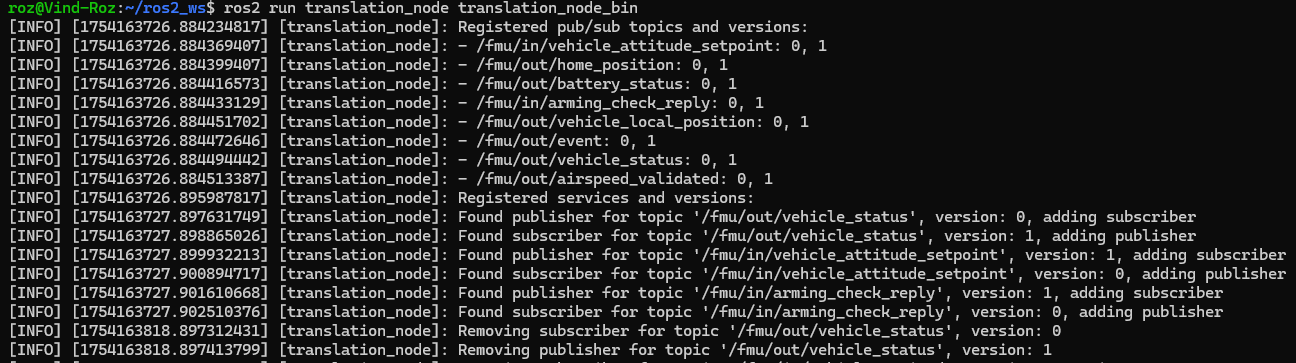

And below translation Node
