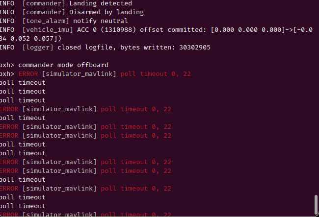

Hello, I am also getting the same error only when i try to do offboard control in PX4 SITL. Have anyone found the solution??
I’ve been facing the same issue for the past two days. It could be related to network port connectivity. Make sure that PX4 is connecting to the correct port and that the port is not being used by another application or server. For example, if PX4 is trying to connect to TCP port 4560, but another process is already occupying it, the connection will fail. To fix this, identify and terminate the process using that port, restart your simulator, and then try connecting PX4 again
