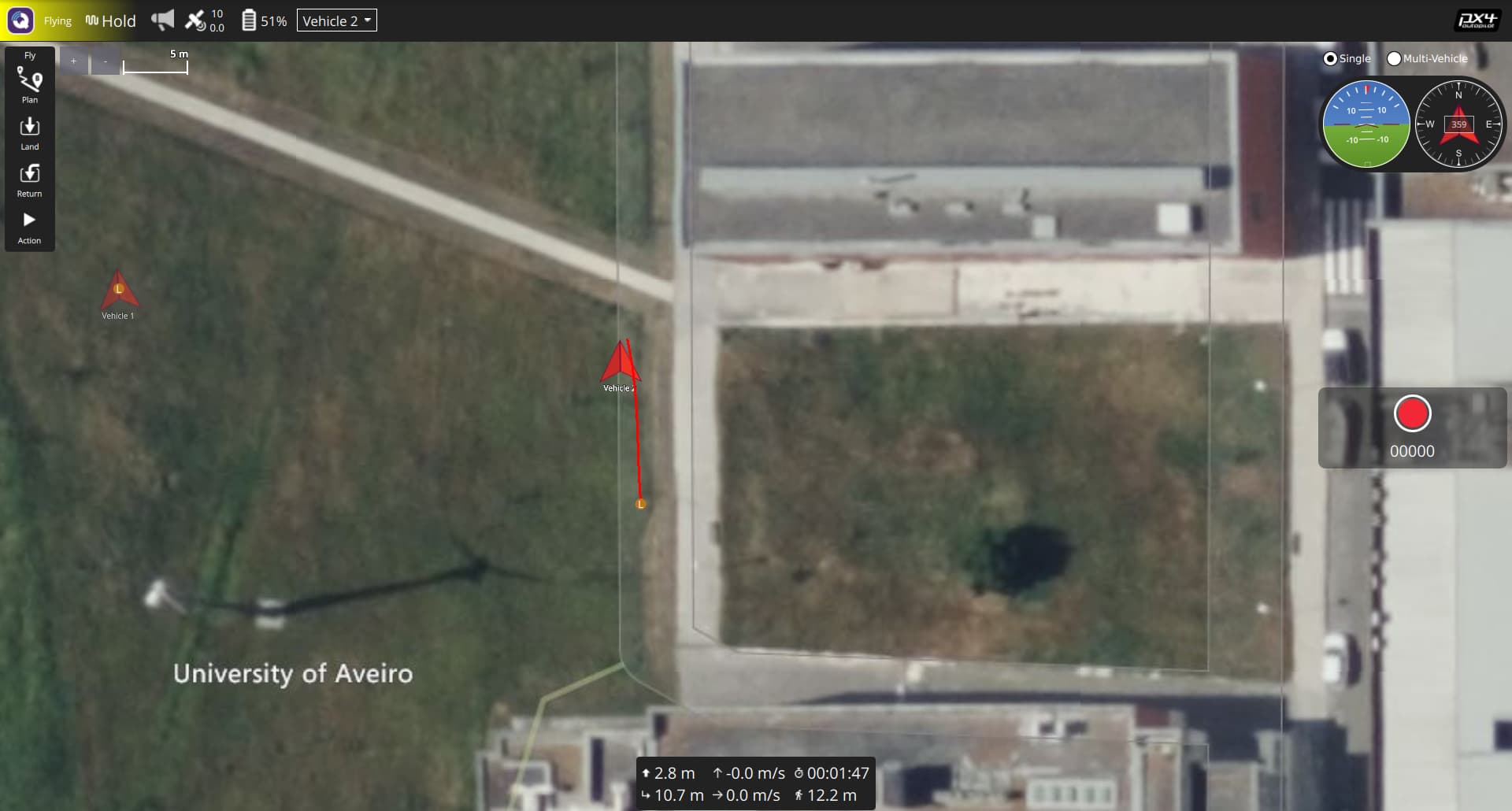

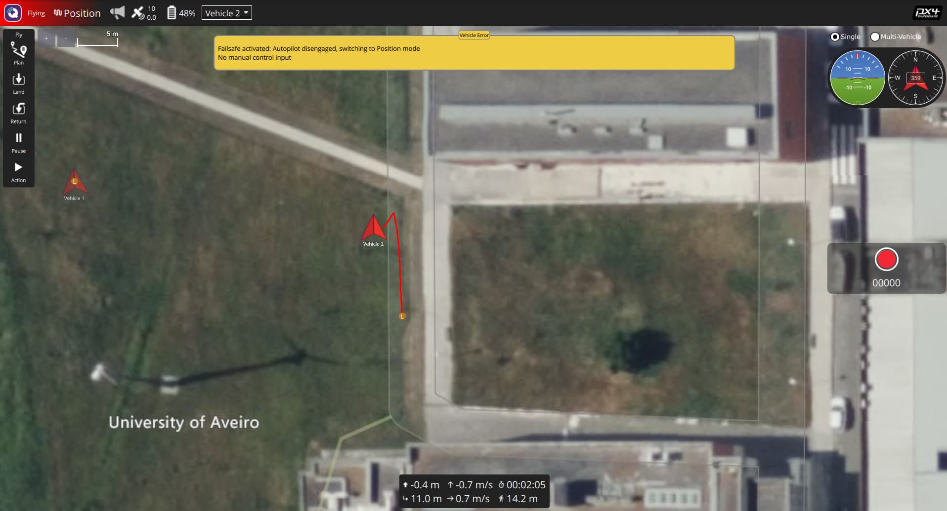

Sorry for the lack of context.This is currently the script i am using for the move function: the variable move_as_goto is set to false.
I tried to add the for loop in the stopping command to be sure that i still send commands after arriving destination for at least 10 seconds.
After this change, i am able to perform a single move command, if i try a second one i immediately get the same failsafe error as you can see below:
First image: After first move
Second image: After trying second move

I actually had that error in my code before, but I had already detected and fixed it — sorry for the confusion. However, moving the break statement after the for loop still results in the same behavior.The drone moves to the place i want, then if i wait 10 seconds it changes to hold. But once i am in hold mode if i try to make a second move i get exactly the same problem. Even if i try a second move during the 10 seconds that i am still in offboard mode (the for loop) the same thing happens.
