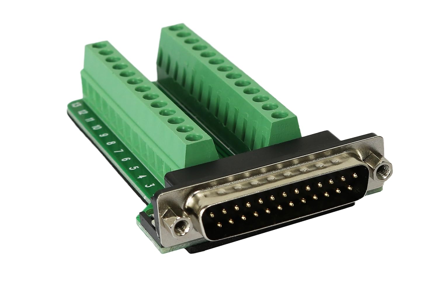

For current PX4 mount, we’re using a vibration mount like this, which does use double sided tape to attach the pixhawk to the vibration mount and the vibration mount to the avionics tray. The Pixhawk and Raspberry Pi companion computer are both installed in a 3D printed sliding avionics tray, which we use to quickly access those components for servicing. The box looks like the following:
We have done a bit of work to neaten the mess of wires leading to the Pixhawk on the left, although it’s still not the best. Current plan is to add the gel linked in my last post to attach the Pixhawk to the vibration mount, use high-flex silicon wire for all cables leading to the Pixhawk, and add some sort of foam material between the motor tube clamps and the tube arms that the clamps attach to. We could also dampen the entire avionics box (shown above), although it would be difficult to isolate noise coming through the cable that we use to feed signals in/out of that box (a DB-25 cable attached to a breakout board).
