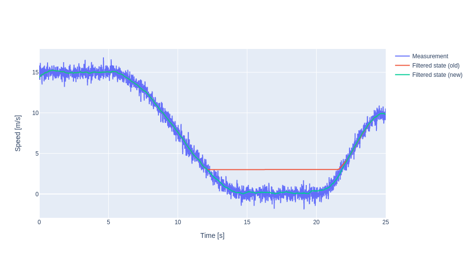

- allow the airspeed filter to reach zero, see the following figure showing the 3m/s cap is now gone ([this script](https://colab.research.google.com/drive/1ebFC5OshLoS_vj1gjhg2FGLiVfG6LUbq?usp=sharing) was used to generate the plots)
- NOTE: this filter should ideally not be inside TECS either. But .. for another PR.
