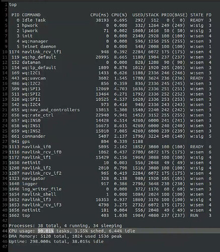

Q.3: CPU usage high
Coaxial quadcopter, Pixhawk 5 hardware
Answer:
- Disable UAVCAN (via parameter), if unused
- Disable mavlink instance that is unused (since using RC receiver, mavlink isn’t necessary)
IMU_GYRO_RATEMAX, if 800, you can turn down to 400, to reduce computation load- MAVLink on USB is also quite slow (due to lots of things being turned on, etc). Using Telemetry ports should be faster.
- Overall, if it isn’t 100%, you don’t need to worry about the CPU usage.
- You can execute
work_queue statusto check what’s going on in the work queue as well.

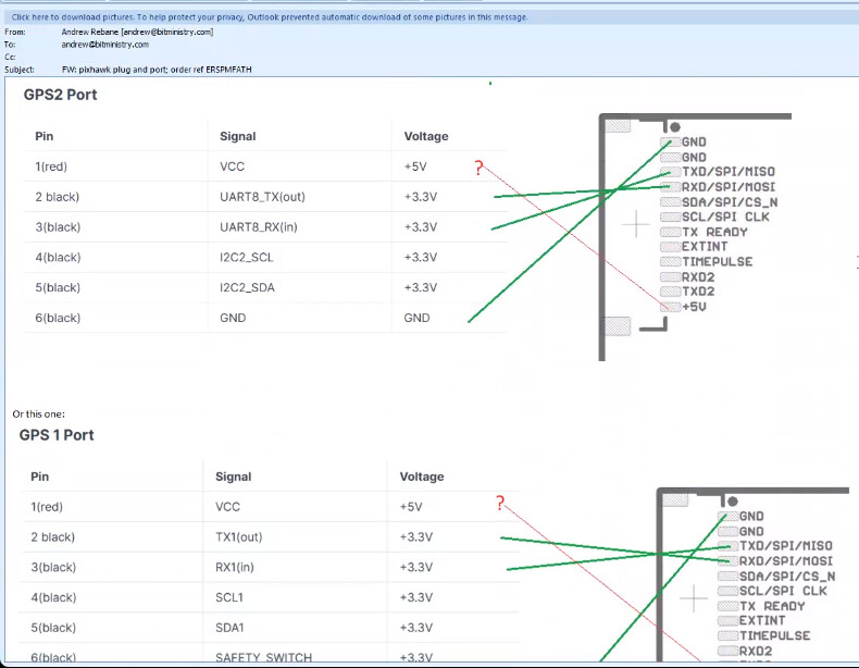

Q.4: RTK GPS connection
Using uBlox ZF9P (?) connection question.
Answer:
- Get the serial port wired up, that should work with default confiugration if connected to serial port marked GPS
- Check out the PX4 RTCM doc: RTK GNSS/GPS (PX4 Integration) | PX4 Guide (main)
- QGC doc: https://docs.qgroundcontrol.com/master/en/SettingsView/General.html#rtk_gps
- Maybe also can check out: RTK GNSS (GPS) | PX4 Guide (main)
- F9P receiver is really good on it’s own, so please try even without connecting RTCM / base station.
- Should work as Plug & Play with QGC (via USB). For Windows 11, could be detected as not a COM port (GNSS), may need to configure it to be a COM port.
