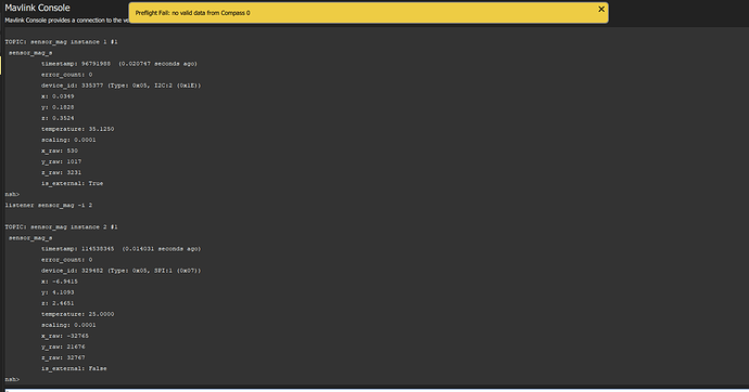

Can you tell me what kind of fc and gps you have installed?
I @Dave84,
my flight controller is Pixhawk 3 Pro and external COMPASS-GPS is DP0105 NEO-M8N GPS + LIS3MDL Magnetometer.
My flight controller Pixhawk 3 PRO you can find it here:
As said, the error I receive is ‘No valid data from compass 0’ that seems to be the internal one. Moreover, if I try to disable it, I still receive the same message. Why?
Could be useful logs and parameter files?
Thank you very much for your time.
Good day,
can you do a screen shot about how did you set your compasses, coz sometimes compass 0 is external.
just make a sensor listener of your mags in the nsh console
follow these instructions:
type ? followed by enter
ls / obj (enter)
type : listener sensor_mag - 0
listener sensor_mag - 1
listener sensor_mag - 2
for every command there is the correspondent result: if its external you wil will find external, if not you will find false.
Hi @Dave84 ,
thank you for your reply.
Please find attached output of what you required.
It seems that the external one is instance 1 (with device id 335377).
Instance 0 seems to be one of the internal compasses. Below the output:
Thank you very much David
Mag 1 is external and mag 0 is internal, just enable also the internal and disable the mag2.
just send me also before this the screen shot of the mags settings you have right now
