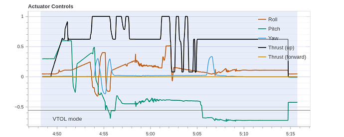

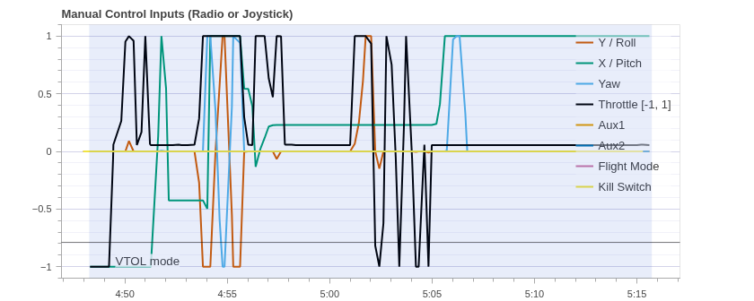

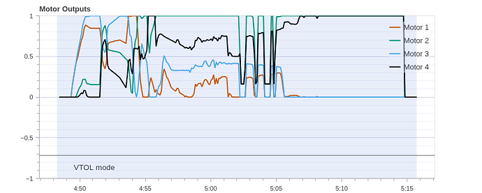

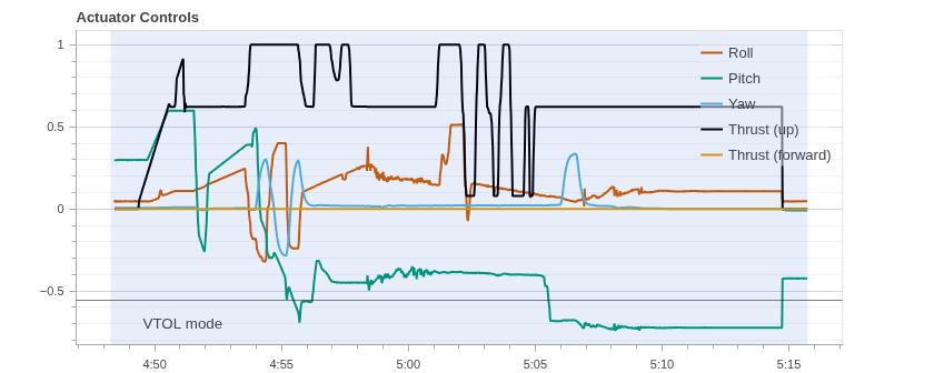

I am using a Pixhawk 6X Pro running PX4 with a Standard VTOL configuration.
In the Actuators tab, the motors do spin, but not fast enough to achieve a real takeoff. During manual flight, the thrust produced by the motors is insufficient, and the aircraft is unable to take off.
In the log files I see that the signal of “1999” is sent from the pixhawk to the ESC, but it never really transfers into high RPM. I tried DSHOT 150, 300 and 600, no difference. Here my actuator outputs logs:

I have searched extensively—using ChatGPT, reading forum discussions, and reviewing the official documentation—but I have not been able to find a solution to this issue. Is there anyone knowledgeable who could help me troubleshoot this problem? I have been trying to resolve it for five days without success, and any assistance would be greatly appreciated.

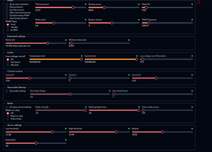

To follow up:

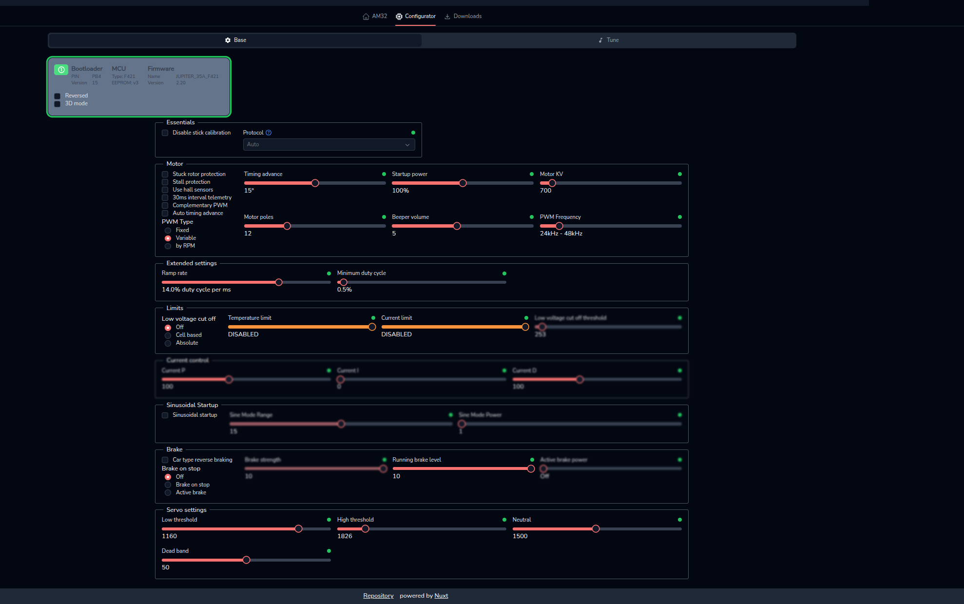

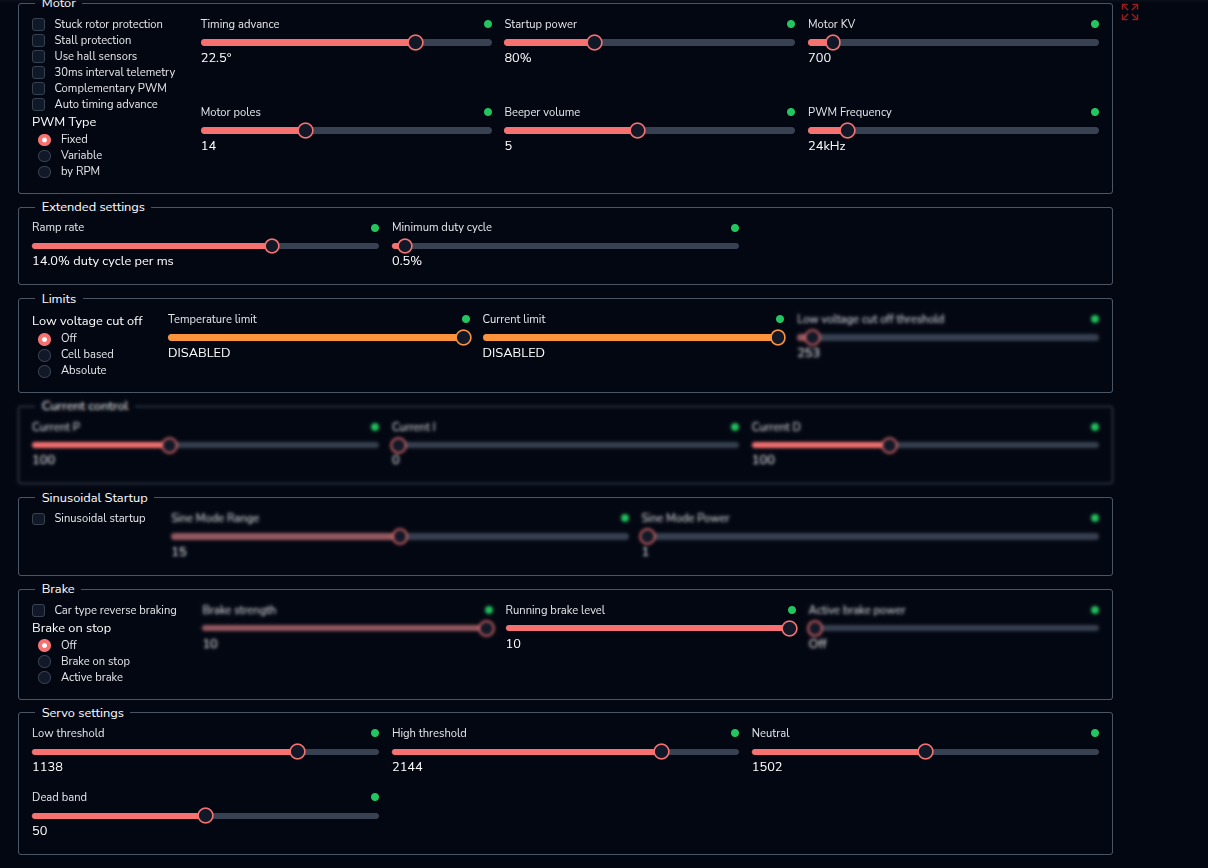

I have purchased a “LINKER” device, and could not connect to the ESC at all. I have now purchased differend ESCs, and now it works for manual flights and power. Skystars Jupiter 35A 3-6S AM32 | Rotorama
The problem was def. the firmware of the ESCs.
Nevertheless, if someone ever has successfully flashed the firmware of the HAKRC BLHeli-32 35A ESC (https://www.getfpv.com/hakrc-blheli-32-bit-35a-2-5s-esc.html?srsltid=AfmBOorpVnVpFW0M-viu_AnDO9Vci0hmK2kacCDfpcEX9F4-dab5AxRZ), please let me know! It would be a pity to throw them away or not use them for another project…
Best
It looks like AM32 supports this ESC. I would try flashing AM32 firmware
