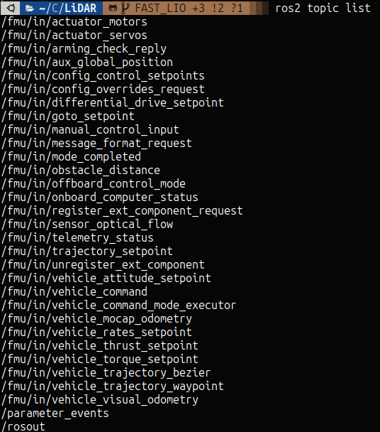

I am encountering similar troubles.
First I need to reduce the baud rate to get something through MicroXRCEAgent (115200 instead of 921600) and even though something goes through it only is fmu/in/* messages.
The funny thing is that I had it working completely fine less than a month ago.
What is different in my setup is that I used to work a fully calibrated drone and now I just have a flight controller connected to GPS.
I cannot do proper calibration as I do not have the RC. But I used the “Offboard” workaround and in general that should not be a problem to get the sensor combined data (I am not planning to fly I just want IMU data).
I saw there was a QGroundControl update and I wonder if that could be part of the problem.
I hope that helped, looking forward to know what is happening.
