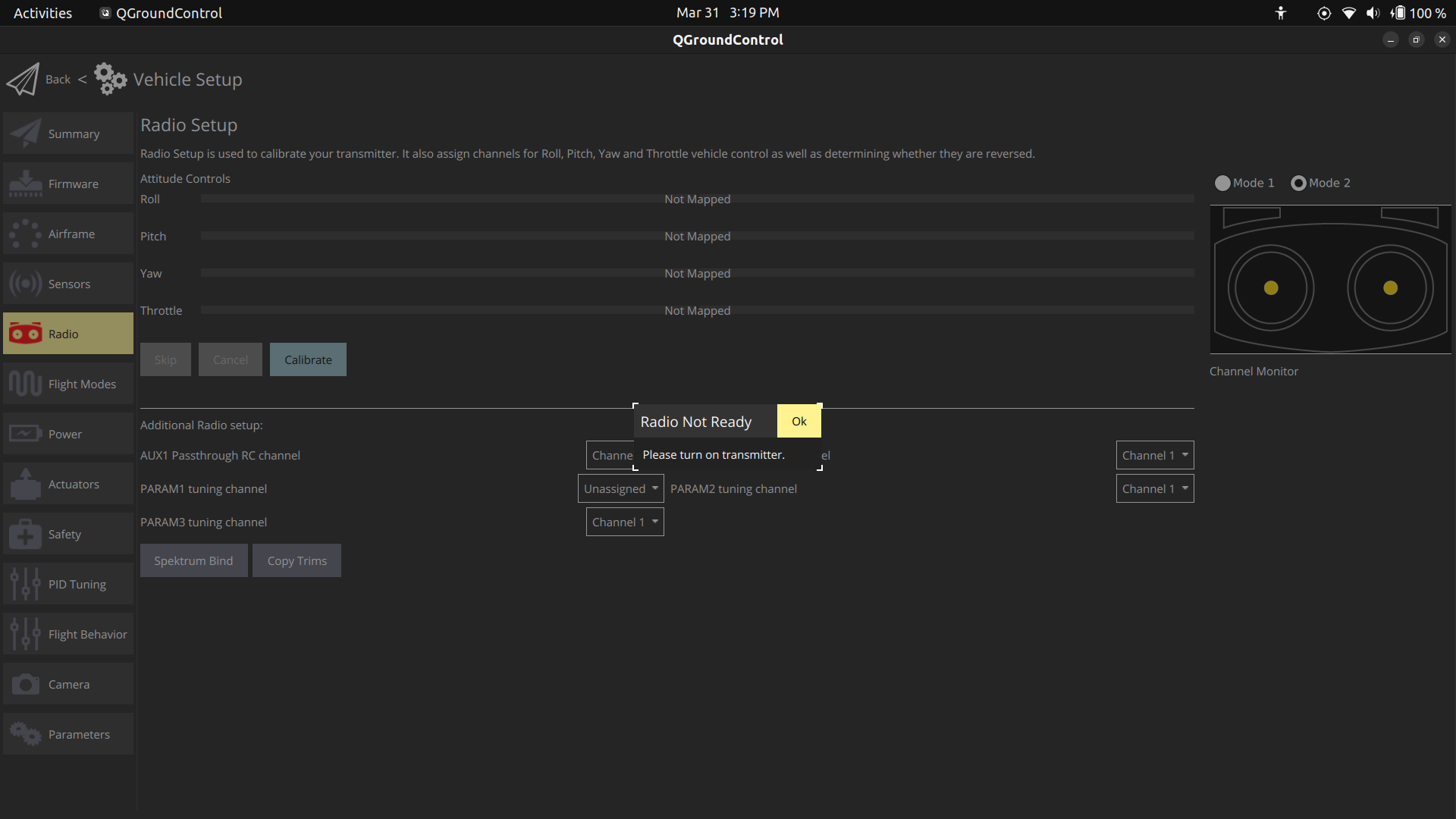

I’m having trouble getting my flight controller to detect any RC input. Specifically, my Pixhawk 6C flight controller is not recognizing signals from my FlySky FS-iA6B receiver, even though the transmitter is bound and the receiver appears to be working. In QGroundControl, no channels are detected and calibration fails with:
“Turn your transmitter ON”

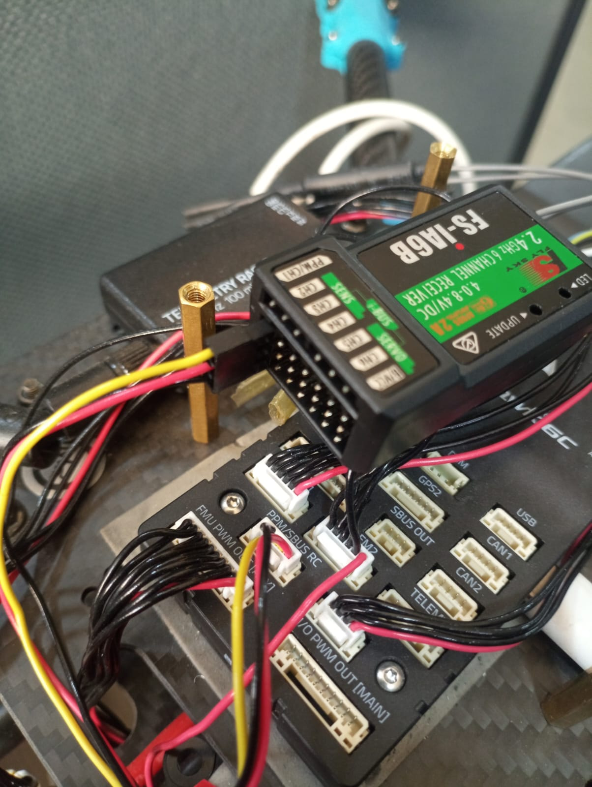

  • Flight Controller: Pixhawk 6C flight controller
  • Receiver: FlySky FS-iA6B receiver
  • Transmitter: FlySky FS-i6 transmitter
  • Firmware: PX4 v1.16 (QGroundControl)
:electric_plug: Wiring (PPM attempt)
I connected the receiver using the PPM/CH1 port:
  • CH1 (Signal) → RC IN Pin 2 (PPM/SBUS signal)
  • VCC → RC IN Pin 1 (5V)
  • GND → RC IN Pin 5 (GND)

  • However, in QGroundControl:
    • No channel movement is detected
    • Radio calibration fails with:

:counterclockwise_arrows_button: iBUS Attempt
I also tried using the iBUS port on the receiver:
  • iBUS signal → Pixhawk RC IN signal pin
Result:
  • Still no input detected in QGroundControl
  • No channel activity

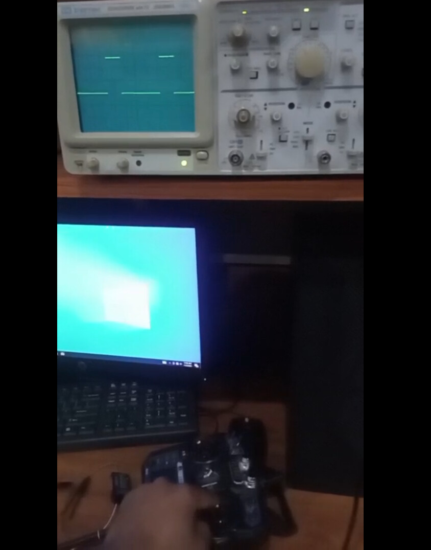

Thanks for the reply.
I am using PPM protocol. I have tested the reciever Fs-ia6b using an oscilloscope today, confirming that it indeed is spitting out valid PPM signals.
However the pixhawk does not seem to see any signal. I.e. QGC does not show any radio input.
I am unsure on what to do. Tomorrow i will try to simulate a static SBUS signal using an arduino to see if the FC recognizes that protocol (I do not have a receiver with sbus output).
If you have any suggestions, they will be MUCH appreciated.
