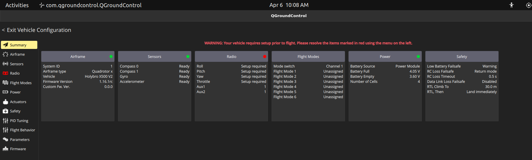

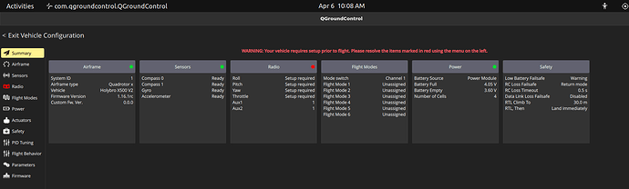

I encountered a few errors when controlling via the PPM signal. I tried several control modes, and sometimes the controller seems not to work.
Sorry for late reply. I bought the receiver fs-ia6b, but when connecting it using PPM/CH1 channel to PPM/SBUS RC port on the 6c. I do not see the controller on QGC. Even though the transmitter is bound to the reciever and ppm output is turned on in settings. When i turn ppm output off and manually connect a motor to ch2, the motor spins meaning something is wrong with ppm or my controller. Also tried using i-bus channel but that too does nothing in qgc. No transmitter inputs show up and clicking calibrate button gives error: “Turn your Transmitter ON“.
Do you have any idea why this could be happening and what i can do better?
Thanks!
Which version of PX4 are you using? I am using version 1.16.1 and it recognizes the controller on QGC. You can try it.
Using Latest stable 1.16.1rc aswell. Also using latest stable QGC version 5.0 too.
But still the issue persists. Can you share images/params for your setup? Maybe that helps?
I don’t know why either. I tried many different versions but only that version worked normally. At that time, I didn’t adjust any other settings. Hopefully you have fixed it.
imagei use QGC v5.0.8 you can try it. When I tried a different version of GQC on my friend’s computer, it also didn’t recognize it, but when I switched to my computer with this version, it recognized the RC.
