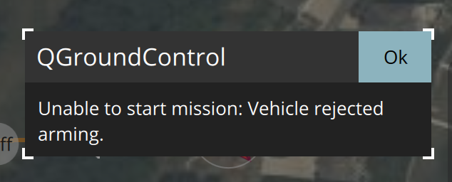

I had that parameter set to 1 originally. After changing it to 0 I tried arming, and it said failure to arm in a popup message, but in the top left corner says armed. My GPS is flashing yellow and beeping.
