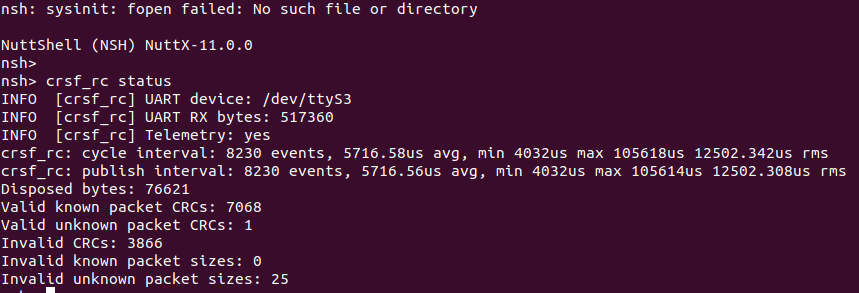

I built the firmware with the crsf_rc module included, the input_rc module was actually aleady disabled in the boardconfig tool by default?
I am recieiving telemetry messages on my transmitter, but when trying to calibrate the radio in qGroundControl I am not seeing any activity on the channel monitor and flight controller does not seem to be recieving anything from the transmitter.
Can anyone suggest how I should be trying to debug this issue? I connected directly to the FC using screen to get the nuttx prompt up, but am not actually sure if the output is normal or not, seems to have a fair few errors?
also had a look at the dmesg output, but again not sure if its normal or not:
Any help very much appreciated, please let me know if there is more info I can provide.
Thanks,
Alex.
Had my packet rate on RC set too high for the receiver, seems to be working fine after correcting this.
