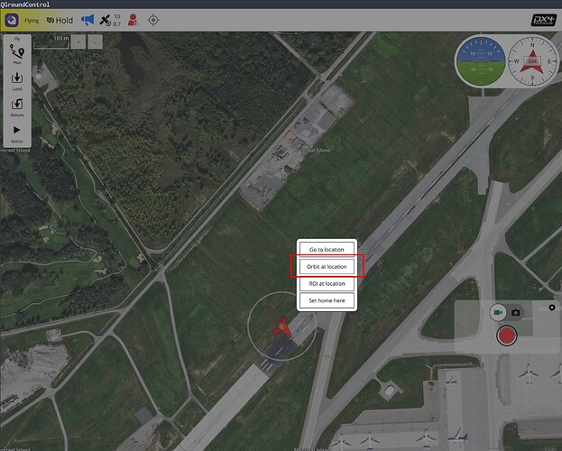

Hold is the same as loiter for a multicopter in PX4? Is there a way to orbit a circlular path with a given radius for a multicopter?
Yes, in QGC you can click on the map and select Orbit.
I’m using 1.14 of PX4 and v4.3.0 for QGC. I don’t appear to have that option available, is it in a newer version?
I think that should be there.
This is what I see with PX4 v1.15 and QGC v4.3. I’m pretty sure it was there in PX4 v1.14 as well though.
