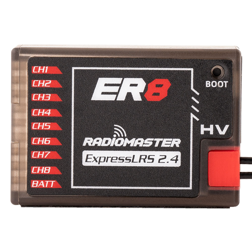

There are many receivers available for your transmitter.
One suitable example:
But as mentioned many to choose from:
Once you have the receiver just bind it and connect to FC. Start radio-calibration and other sensor calibration.

Thanks for the info , I am trying to find out the difference between all the different kinds of receivers over there .
I am unable to figure out what is needed for my quadcopter and also what is the difference between RP1 ,RP2,RP3 ELRS Nano Receivers and ER4 ER6 ER8 2.4GHz ELRS PWM receivers?
Also do I only have to buy the receiver or any other extra hardware with it ?
Those are basic RC-Hobby related questions and can be answered by those forums.
Some quick info: The number behind the model type is the amount of channels it has. I.e. ER6 means it has 6 channels available. = You can connect up to 6 devices (servos,motors,aux-switches,…)
The Letters in there refer to the design of the receiver. As seen in the photos of the radiomaster website. Those with “ER” are regular fully enclosed receivers. = Just plug your servos, motors and other equipment in.
The "RP’ series appears to be a bare bone design to save weight and reduce size. But this also means you have to solder everything onto it and perhaps make your own casing or find other ways to protect the circuit board. = More specialized product to suit very specific applications.
Since you have bought a 12 channel transmitter wouldn’t make much sense just buying a 4 channel receiver.
→ 4 channels is the minimum you’ll need to fly a drone. (throttle, yaw, pitch, roll)
Given that most people will add a camera, aux-switch, gimbal or any other additional equipment, it makes sense to have a few channels to spare on your receiver. (The only time you want just the bare minimum is if you intend to use a very small, lightweight drone and can afford the extra space & weight)
2.4GHz is the frequency it operates on.
ELRS is the type of signal it uses. (Think about it like a specific language)
Thank you so much @Karl_S , now it kinda makes a lot of sense to me . And as you have mentioned, about the channels in the receiver, could you please point me towards the one compatible with my RC, by compatible I mean the one that has all 12 channels on it … that would help me a lot.and is there any way I would be able to know how many channels a RP receiver has ?
I was also thinking to buy RP3 ELRS Nano Receiver. (Does my decision make sense? Or is it terrible :smiling_face_with_tear:?)
Your consideration for the RP3 ELRS Nano receiver makes no sense. It is exactly the type you have to solder wires to it and also find a way to protect it with casing or at least shrink wrap.
This one allows you to simply plug in devices without soldering and without having to find a solution in regards to casing.
As the number “8” suggests, it is a 8 channel receiver allowing up to 8 components to be connected. That brand hasn’t got any 12 channel receivers and you will find it hard to find any, as some of the other channels are used for additional functions like flight mode switching, landing gear activation, motor safety cut-off,…)

The RP3 passes all the channels from your transmitter to the FC. - But no way to connect any devices (servos,ESC’s,…) driectly.
Out of the 3 Nano receivers the RP3 is the best one with better range and two antennas.
