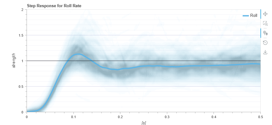

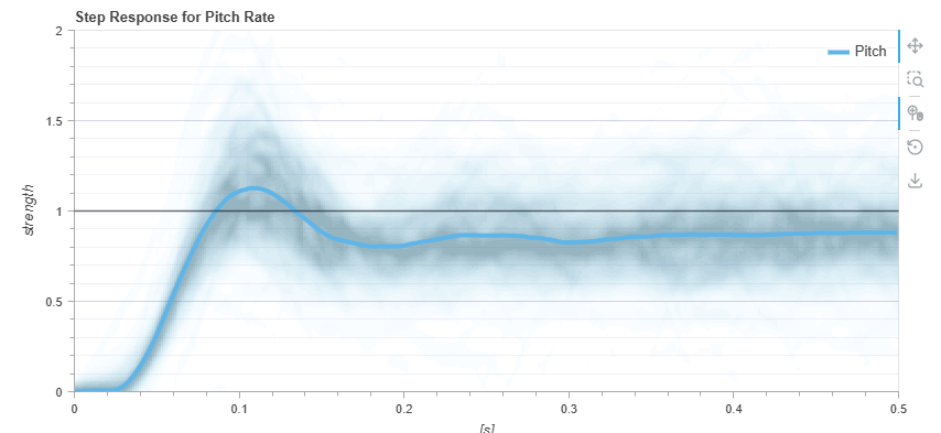

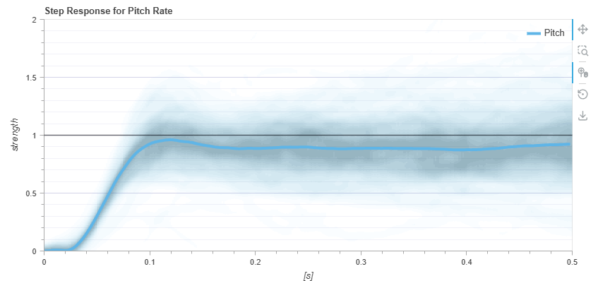

Hi, I was tuning the Rate controllers of my large drone today.
First log: https://review.px4.io/plot_app?log=2d535d24-7193-4373-b26e-062a9818eb08
Second log: http://localhost:5006/plot_app?plots=pid_analysis&log=1c7cb257-05f3-46c2-bbd4-78c4c58bd5c9
Could someone tell me if I can just stick to the PID values in the first log? It looks decent enough and I’m not sure why it still not reaching the value 1, should I increase I-term?
Also, the drone weight is around 9kg and motor-to-motor diagonal around 1.1m.
First tune:
Second tune:

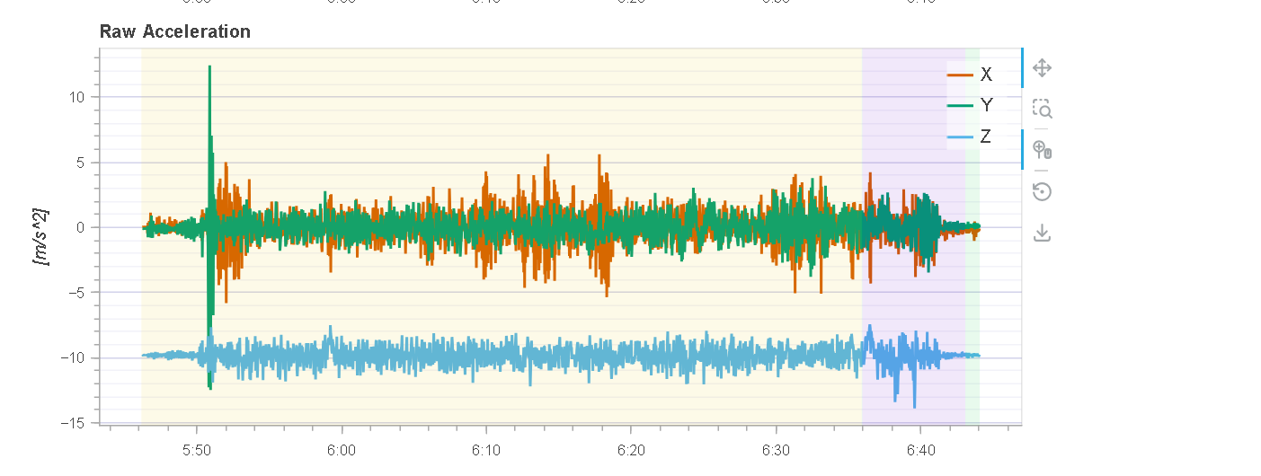

also how do you fixate your component on the drone?

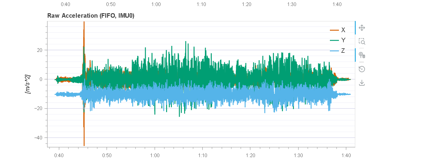

I am using drone frame with mtow of 9kg and looking for way to lower emi, or any noise as much as possible

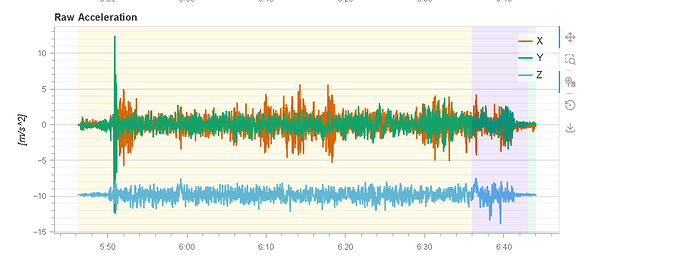

The accelerometer indicates that the vibration is quite significant. Has the flight control system been designed with shock absorption features?
@gfLv_amov
Hi, Yes. I’m using Cuav V6X V2 FC. They claim it has a shock absorption.
Also, On the frame everything is tightened. But I’m using 25mm OD and 1mm thickness CF tubes for the arms, could be the thickness contributing for the vibration?
I’m not using any dampeners for the FC.
Yeah, what do you mean by fixate my components? I’m using CF plates as the base plates for the drone, everything else is mounted.

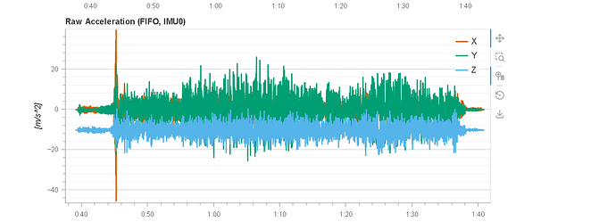

Today, I mounted the FC on Damper balls and this got things worse, the log below is for one of that. We tried even going back to default PID values, but things didn’t solve.
Removed the damper balls and mounted the FC back on double-tape foam. The logs below are from after we slightly change the PID values,

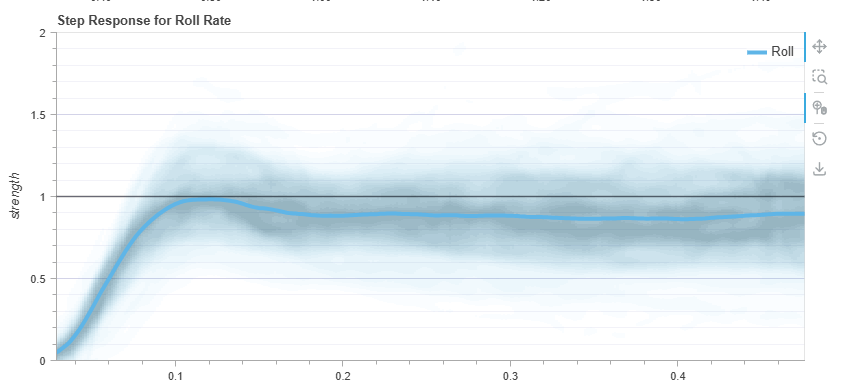

So again today I made sure the frame is stiff and nothing is loosened. Before starting tuning I also limited MC_ROLLRATE_MAX, MC_PITCHRATE_MAX, MC_YAWRATE_MAX, MPC_MAN_TILT_MAX, MPC_TILTMAX_AIR.

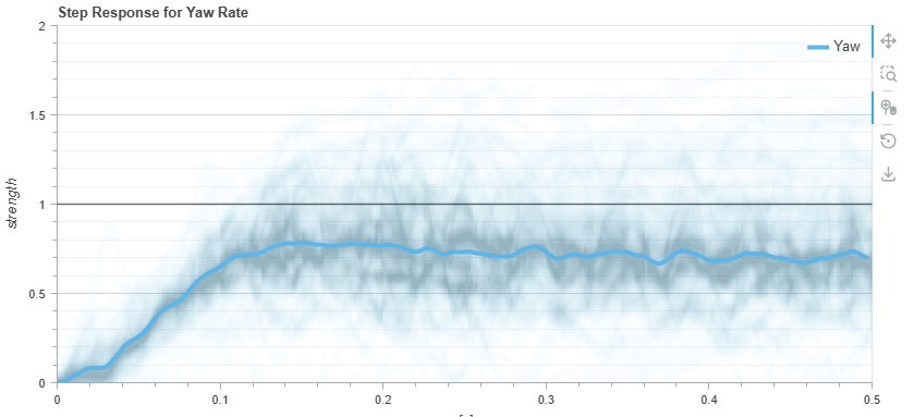

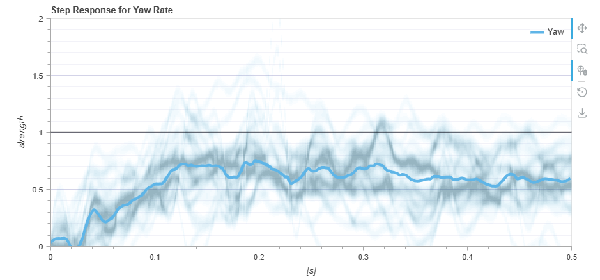

I understand I need to increase the K for yaw rate, but isn’t the PID curve for Roll Rate and Pitch Rate enough as of now?
Any advice much appreciated!
Thank you!

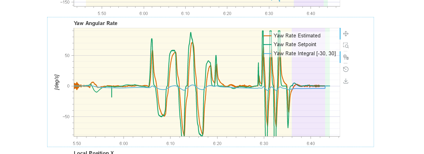

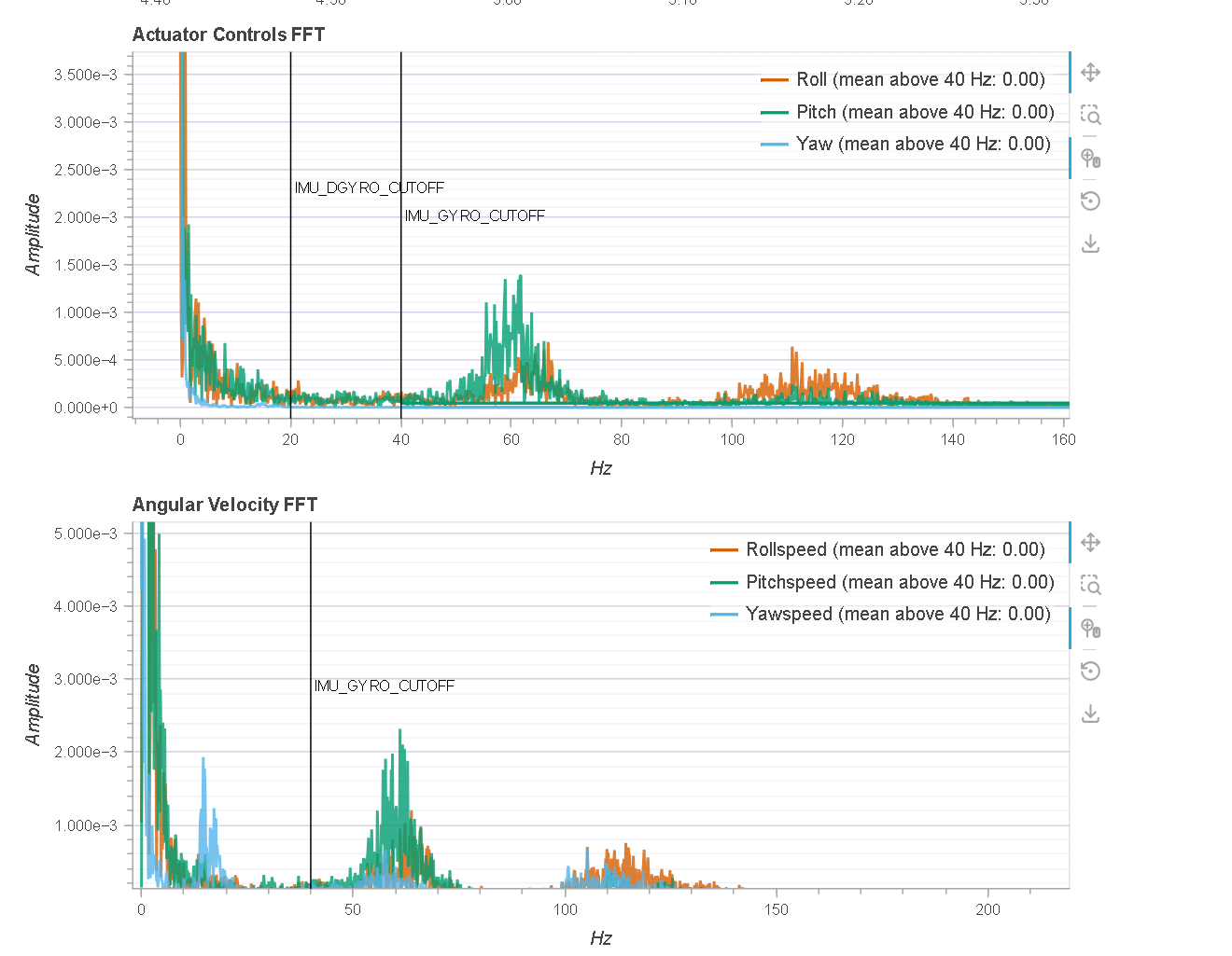

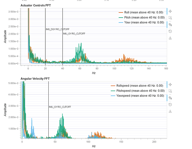

The vibration effect is good, but I saw two issues in the log. One is that the cutoff frequency of the IMU can be appropriately increased to filter out some vibrations around 60Hz.
The second issue is that the tracking effect of the yaw rate control loop is not very satisfactory. It is recommended to slightly increase the value of MC_YAWRATE_P/K. However, this is not an absolute solution and it depends on the actual flight performance.

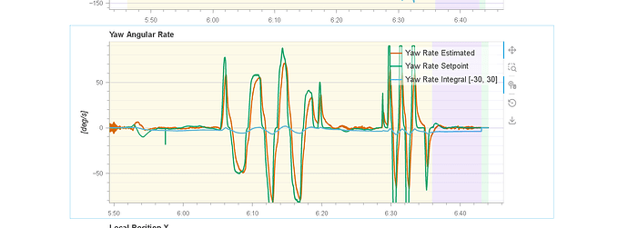

I tried tuning and increased the Yaw Rate K value higher and got good response. But at around K=3.4 when I had almost good time-series graph with Setpoint and Response I ran into some issue (not sure if it’s really).
I was doing sharp stick turns as I did with Roll, Pitch but with yaw, suddenly the drone just got lowered a few centimeters (Like drone dropped). I guess it’s due to that when doing the sharp stick turns that diagonal pair reduce it’s RPM suddenly. I’m not sure if it’s because of the drone weight is high, after that I set K=3 and Yaw Rate=90 deg/s and didn’t try sharp stick turns lol, I’m afraid to crash this big boy again.
