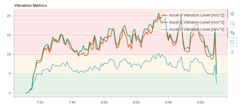

You have severe vibration, it is evident in both logs
After several testing, finally got consistent stable flights with GYRO_CUTOFF = 30Hz, DGYRO_CUTOFF = 20Hz, and static notches. Going lower (15-10 Hz) made it too sluggish. Intermittent EKF2 gyro faults mid-flight was solved after changing FC. Vehicle is auto tuned initially and tuned manually later.
But still having issues with high vibrations, motors getting heated up mainly with full tank load.
Even the drone is not holding its position well and visible slow movements in position hold.
Log: https://review.px4.io/plot_app?log=4c017836-fac0-449a-86a2-ae241faa3a02

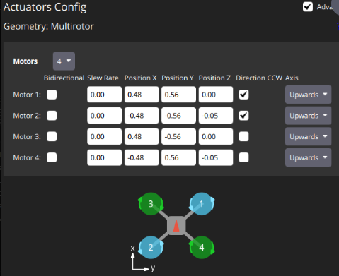

Here’s the motor geometry:
