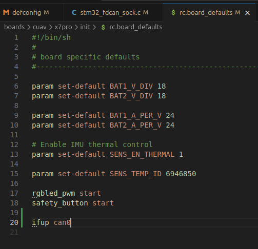

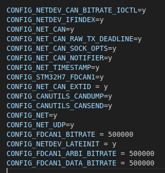

I’m using a CUAV_X7+. I testing out the CAN communication on this controller.
I did the configurations as mentioned.
PX4-Autopilot/boards/cuav/x7pro/init/rc.board_defaults

PX4-Autopilot/boards/cuav/x7pro/nuttx-config/nsh/defconfig

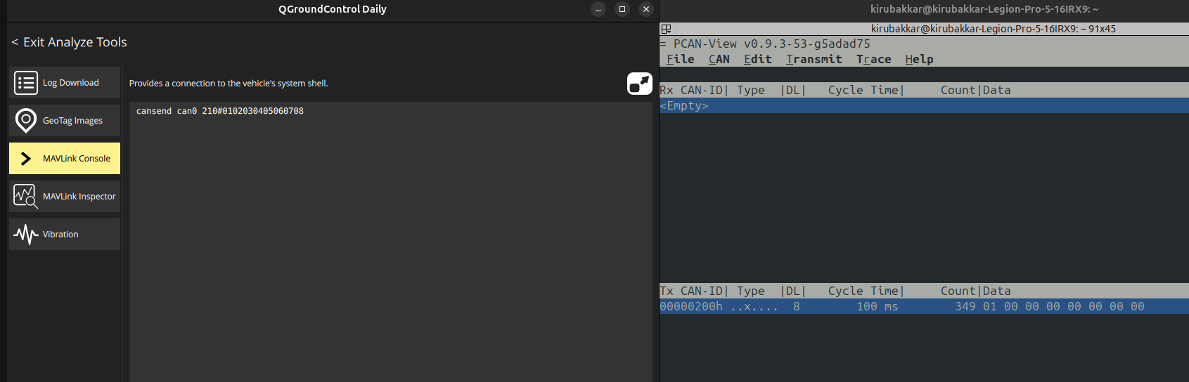

But when running cansend/dump. The console freezes and it’s not receiving or transmitting messages.
