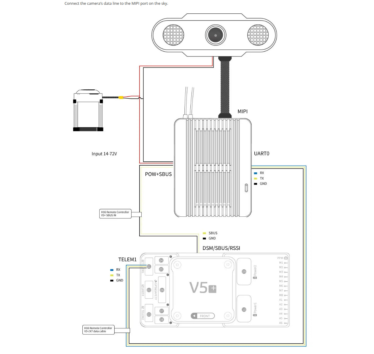

On the topic of the 6C, I’m trying to connect a Pixhawk 6C Pro autopilot to a Skydroid R16 receiver.
The manuals seem to indicate I should connect the Pixhawk 6C Pro “PPM/SBUS RC” output to the R16’s “POW+SBUS” port.
I did this but get no power on the R16.
The R16 needs a minimum of 7.2v but the 6C output is only around 5.2v. That could be the problem. Or maybe there’s no power out of the 6C from the “PPM/SBUS RC” output.
Can anyone please give me some pointers on how to power the R16 receiver from the Pixhawk 6C Pro?
Do I need a Y harness with two leads from the power board to two pins on the R16’s POW+SBUS" port, along with the cables from the SBUS from the Pixhawk 6C?
Thanks for any help…

I’m new to this tech so am not sure what I am trying to do exactly but my goal is to power the R16 receiver. I don’t know if it has an internal battery (I haven’t read about it) but it has a port called BATT+SBUS so I believe this is power IN. I’m not trying to charge but to power the R16.
That image of yours is what I was picturing. Is that normal when setting up Pixhawk 6C Pro to the Skydroid R16? No other way around it?

I think that diagram is illustrative, but not certain as mine is a 6C Pro, not a V5. I will try the 6C’s PPM/SBUS to the R16’s BATT+SBUS, and the powerboard also to the R16’s BATT+SBUS.

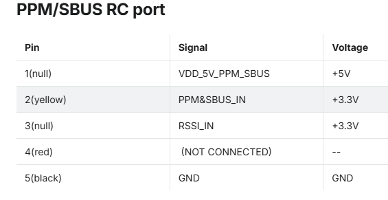

Which of these five pins out of the 6C’s PPM/SBUS port do I send to the R16’s BATT+SBUS? Obviously the #5 pin (GND). But which of the other four?

I’d assume 2 PPM&SBUS_IN goes to the R16’s SBUS Pin, and GND as you said.
Note that this will only give you the RC/SBUS signal, but no telemetry data transfer, which requires the UART to be connected.
You need to connect the power of the R16 to the XT30 Acessory port, for it to work properly then.

Can you confirm there is no (or not enough) power from the 6C’s PPM SBUS port out to power the R16 if I ran a cable from there to the R16 (all pins)?
Thanks for the help…
The issue is the voltage that is too low (5V instead of 7.2V). The current limit would not be an issue I assume.
So do not do it!
