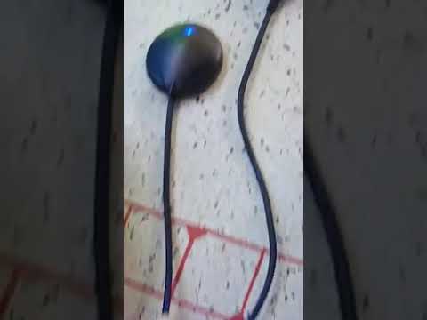

Dear all,
I using last Qgroundcontrol version and flash ver px4 is : 1.11.3
so FC don’t see GPS! mys GPS is RadioLink SE100.
I testing GPS with U-blox, It work!
I think GPS port was broken. So I trying change jack gps to Serial 4/5, Telem1, Telem2 and config it with GPS2, Telem1, Telem2. But FC not see GPS.
Please helpme to fix
Thanks
Reed.
What lights are on your GPS? It should glow solid green for an accurate GPS. GPS may not receive very well.
Check out this document for led meanings
https://docs.px4.io/master/en/getting_started/led_meanings.html

Thanks @Soren, @merve
I set baudrate of 2 gps are 9600, a doing step by step.
And I install 2 GPS, 2 of them are u-blox. and setting GPS1 and Serial 4, But NO GPS.
before 3 year, I used Radio Link SE100, It worked perfect.
Please see video and picture and help me.
Thanks anh Best regard.
Reed.

Dear @roomez
Thanks for your reply.
I measure, voltage are right: VCC : 4.8v, Tx andrx: 3.29v.
I test Serial 4/5 as telemetry port, it work so when I using this port for GPS second, QGC not see GPS.
Thanks
Note: If you have free time, help me ultraview, teamviewer to see parameter ara mistake
Reed.

no problem your parameters.
Hardware problems, especially the GPS module, are more likely!
