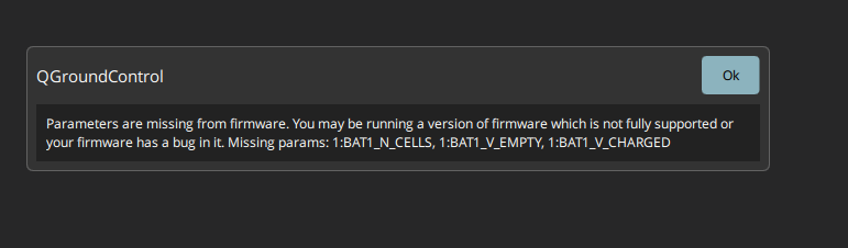

Missing battery parameters PX4 Ver: 1.15.4
I have a Holybro Pixhawk 6C Mini.
It has PX4 version 1.15.4 - which I believe is the latest stable release.
I’m using Qgroundcontrol version 4.4.4.
When connecting the flight controller to Qgroundcontrol I get error related to missing parameters.
I’ve tried using the latest release/beta version of both Qgroundcontrol and PX4 - nothing resolves this problem.
It appears that my version of PX4 has old deprecated versions of these parameters - such as BAT_N_CELLS, BAT_V_EMPTY and so forth.
How do I resolve this problem? I’m guessing I will either need to add the missing parameters - or use a version of Qgroundcontrol that is OK with the old parameters I have on my PX4.
Thank you for your help and advice.
It should be fine to just ignore this error message
OK - I found the way to get the new parameters.
And for what it’s worth - I found the answers by asking Microsoft Co-Pilot - so AI to the rescue!
Co-Pilot suggested resetting the parameters to “default”. Co-Pilot listed a couple of ways to do that - and the second method worked.
So I’m in business now. Thanks!
