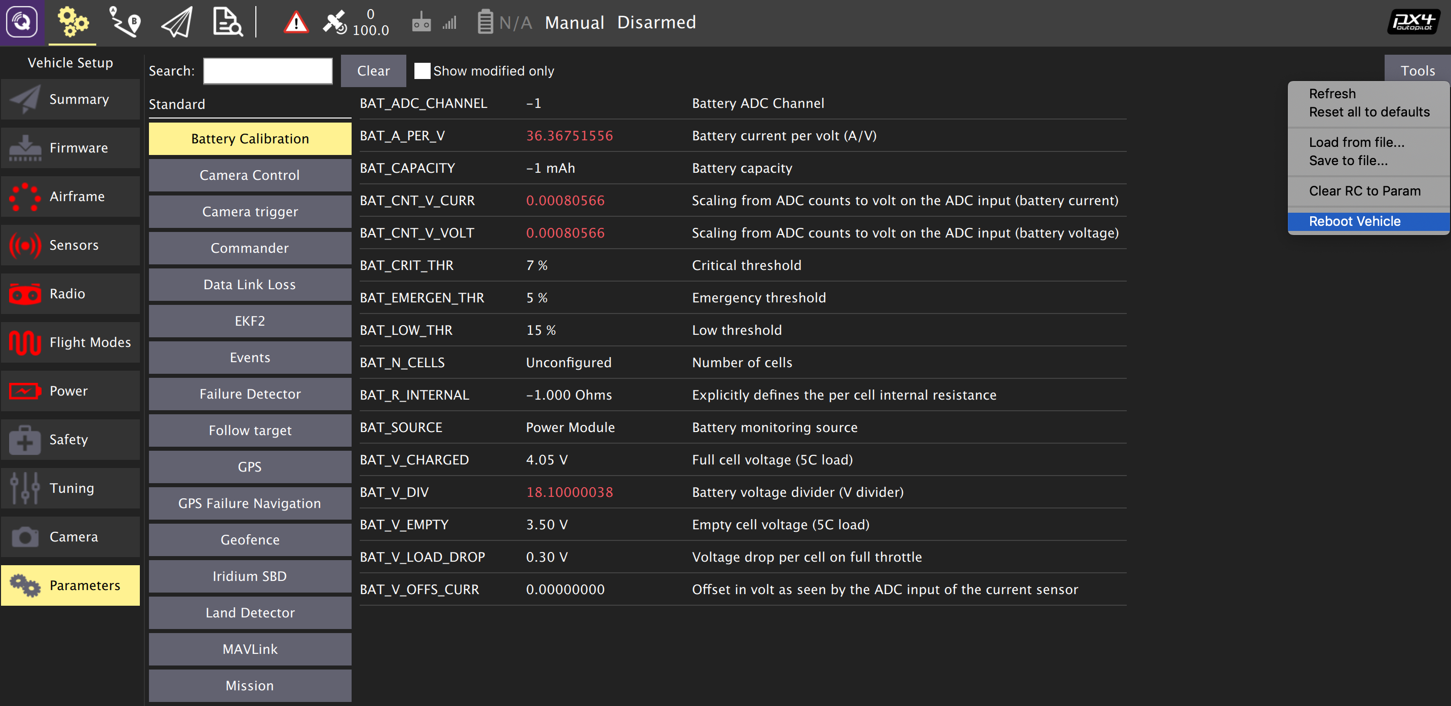

I recommend to reset all parameters and do a fresh setup. The screenshots below show how to do that:

I bought a pixhawk 4 and I had the same issue. After updating the firmware to the latest stable version I had the same message. It was fixed when I reset the parameters as instructed above.
Before doing the resetting procedure I tried to save the parameters. But If I load again those parameters into the flight controller the message re appears. I was just being lazy and trying to avoid calibrate the sensors again.

i clicked on reset parameters to default but getting the error vehicle didn’t respond to command MAV_CMD_PREFLIGHT_STORAGE. can anyone help me.
i am using QGC version v4.2.3
I formatted the SD card and the bug disappeared.
