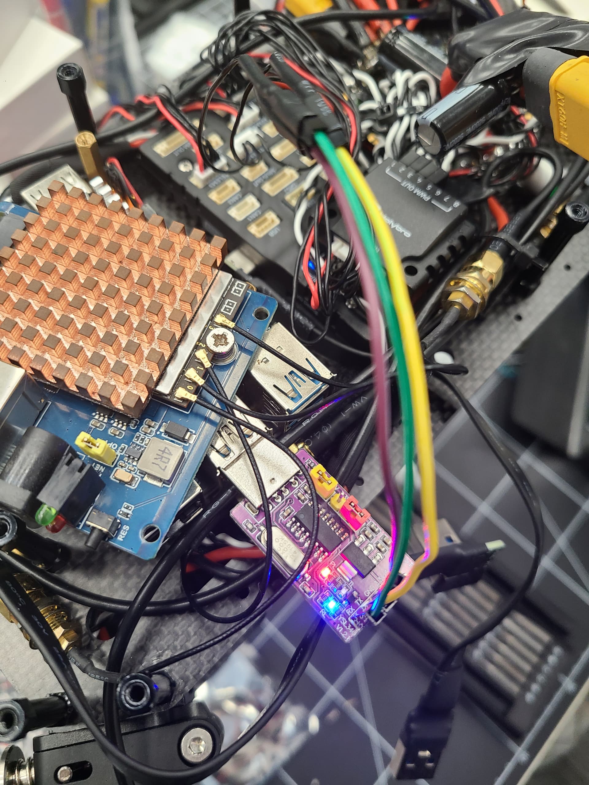

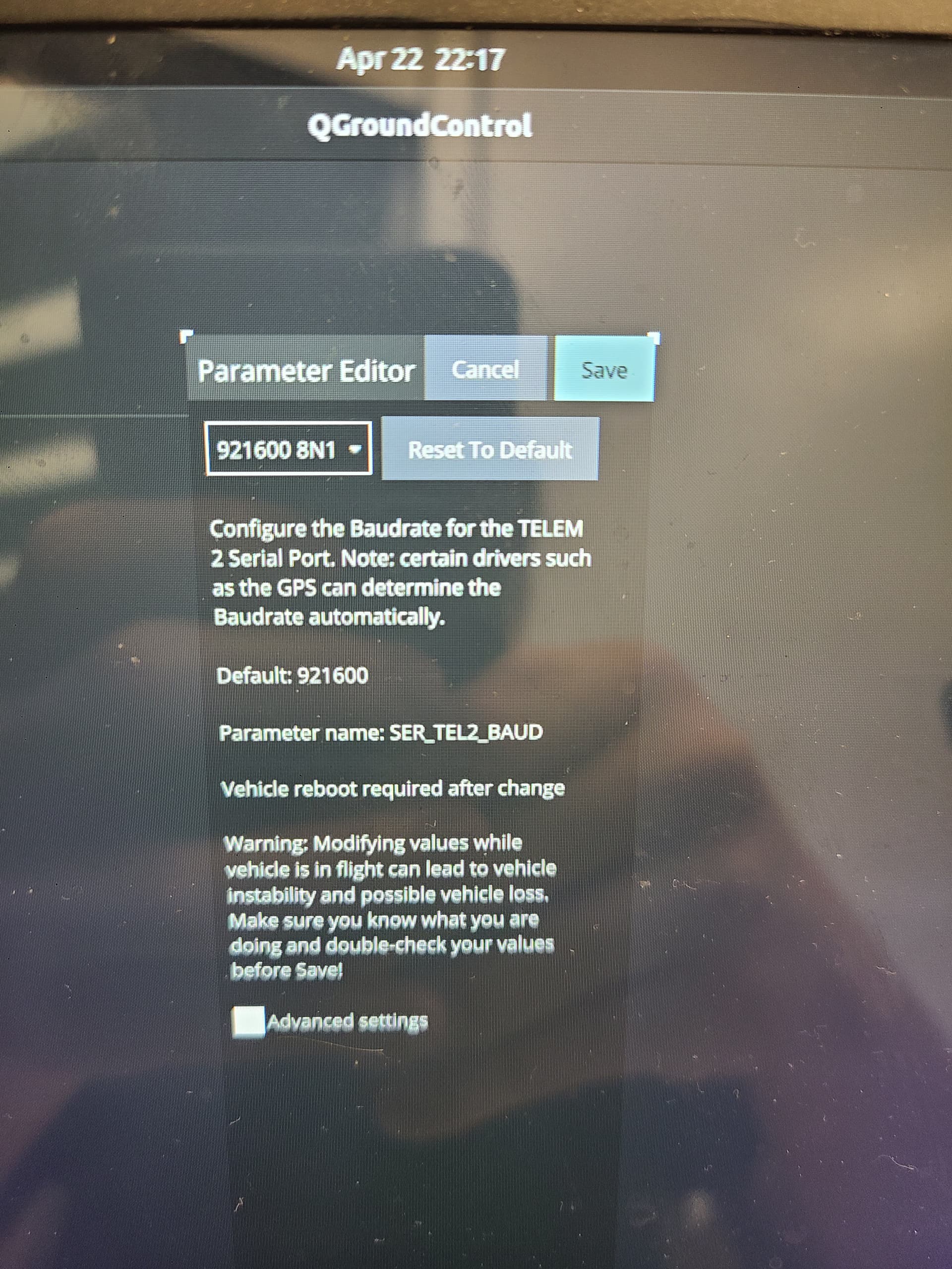

Hi, Me and my team are working on offboard control for a drone. Right now we are trying to connect our companion computer to Pixhawk6c via USB/UART RxTx - ttl - telem2. No matter did we use UART or USB, we always could get the MicroXRCE client to create topics yet they are not shown on ros2 topic list.
the serial port for UART we used is /dev/ttyS1 and that for usb-ttl is /dev/ttyUSB0

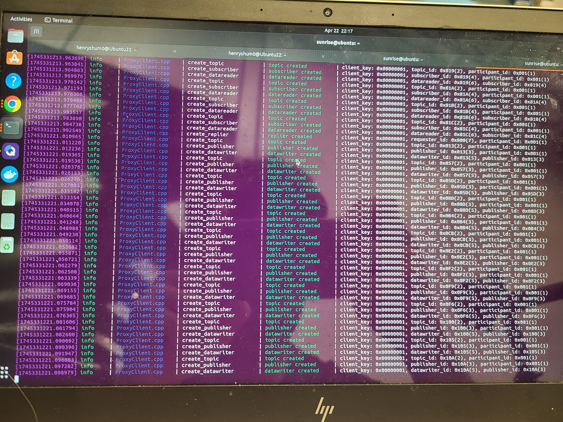

Have you fixed it? How did you install MicroXRCEAgent? I compiled from source with the following Dockerfile and also no ROS2 topics regardless of datawriters being created and uxrce_dds_client status being running and connected in mavlink console of PX4.

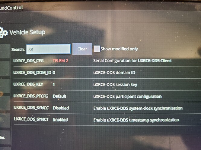

Okay so I searched for the answer for a solid day and came to the conclusion:
Wrong domain ID was set on PX4, I was developing the system previously with domain ID 1 and after changes I decided on domain ID 0 on ROS2 side but forgot to update it on the autopilot. That’s why the datawriters and other good things were created in the agent logs and communication was going (checked with -v 6 passed on agent CLI). The communication now works as expected.
